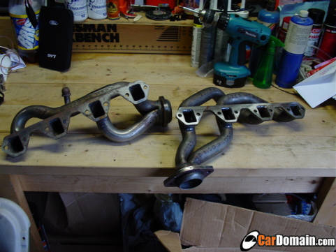

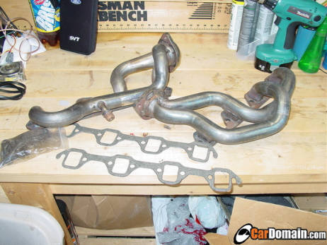

Here are the FMS headers

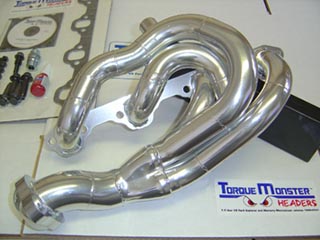

What I've found out through Ford and my travels with getting the correct Headers for our customers is; the early manifolds were used from '96 to early '98 models (until build date 12/97). Then from late '98 (build date 01/98) to 2001 they used the cast iron manifolds. Hence, that is the reason why a '98 model may have the earlier manifolds.
The early manifolds came in 2 types. First type was 96 to early '97 (until build date 12/96) had no EGR bunk on the passenger side and had GT40 heads and an internal EGR. Second type was late '97 (build date 1/97) to early '98 (build date 12/97) with the required external EGR connectivity with GT40-P heads. GT40-P heads were used until end of production of the 5.0 V8 in 2001.
I know this looks confusing, but it's just the facts. All the Best.
Bob Pasquale
Tech Performance & Engineering
Torque Monster Headers
That right there is 1 of many reasons to get the TorqueMonster headers.
