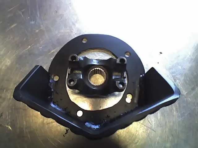

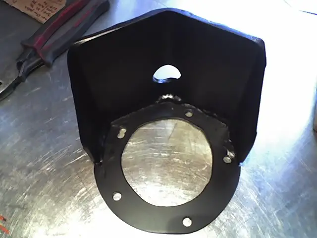

Who can tell me what this is?

A pinion guard for the diff?

I was going to say a 9" pinion guard.

Yup, looks like it will work pretty good. I just hope it doesn't act as a shovel.
I kinda buggered it up when I punched the holes for the bolts but I dont think it will matter.
I also cant cut a good circle with the plasma to save my life.
