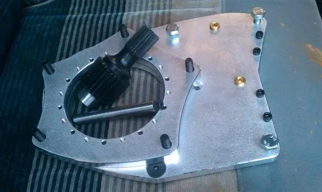

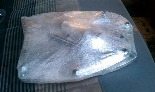

Hmmm. Wonder what this could be?
Here is a better look.
Really nice stuff. Nice machine work. Hope it works as good as it looks. Probably going to just wait and install it when I do the d44 and 9" swap since driveshafts are going to have to be cut anyway.
Double bubble!
Sweet. The rig should walk over stuff easy with your new set up.
Looking forward to seeing the progress here.
I hope so. I think it will help a lot with breaking stuff also. Should be bale to crawl the rocks instead of holding it to the floor to get up them. I think it will help a lot with breaking stuff. We shall see.

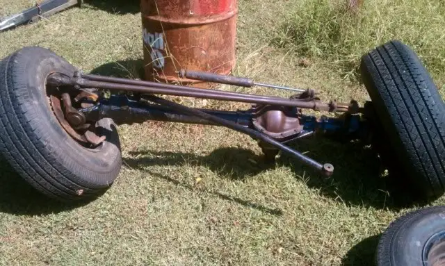

Well picked up another D44 and a 9" and a set of wheels/tires this past weekend.
The D44 has a new 4.88 gear, new bearings/seals, u joints,new Warn premium hubs, new brake parts, and was supposed to have a lockright. Turned out it didnt have a locker so the guy is supposed to be ordering me a Aussie locker for it today.

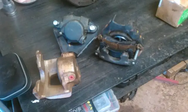

The rear 9" has a 4.88 gear in it and I got a lock right for it also. Got a new set of weld on caliper brackets and gm calipers for disc brakes. Just got to find the right rotors for them.

D44
Hubs/wheels
New 4.88 gear in the 44

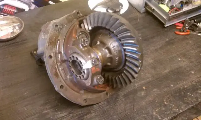

9" Center section with 4.88 gears.

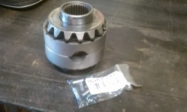

9" Lockright

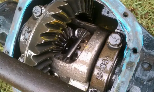

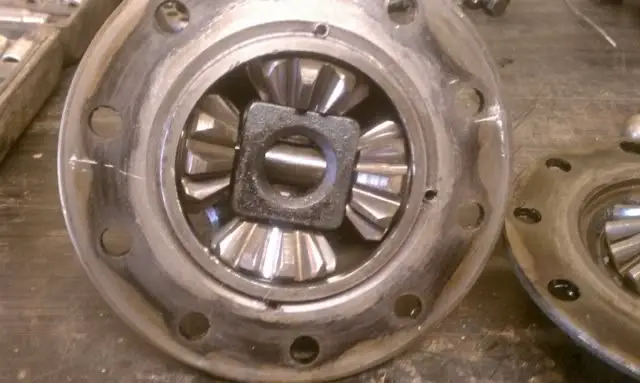

Spider gears
Spider gears no more. Woot.
Brakes for the 9"

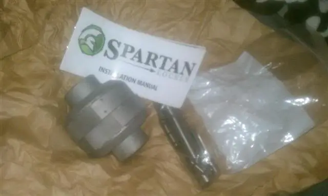

Met up with the guy I got the other set of axles from last night to pick up the front locker he bought since there wasnt one like he said. Atleast he was a stand up guy about it and made it good.
Brand new Spartan locker. Looks like a good locker. Will be a lot easier then other to put it in and take it out. Dont have to mess with the aggravating little springs getting the in and also the pins are about twice as big.

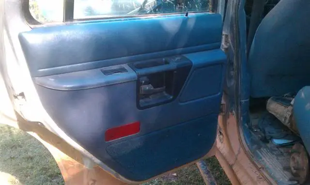

Was at the junkyard today and found a nice looking set of door panels so I grabbed them. All 4 of mine were trashed.

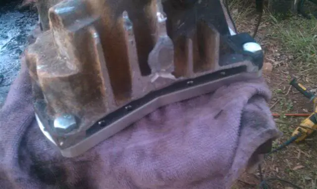

Also got a 1350 from my buddy for free to use the the doubler.
Door panels
1350

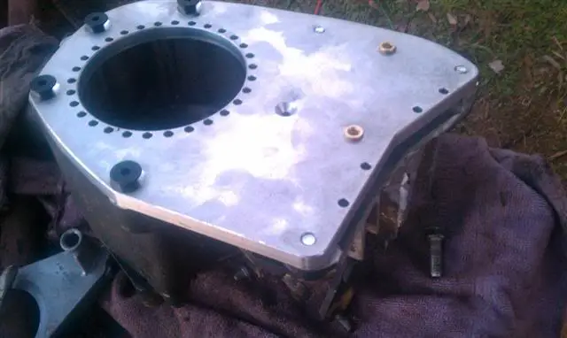

1350 rough cut for the doubler

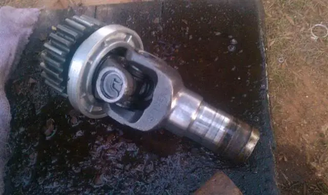

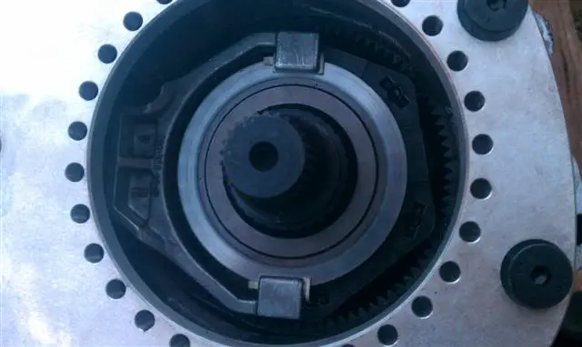

And the little internal u joint on the front output of a 1350 in case anybody ever wondered about it.

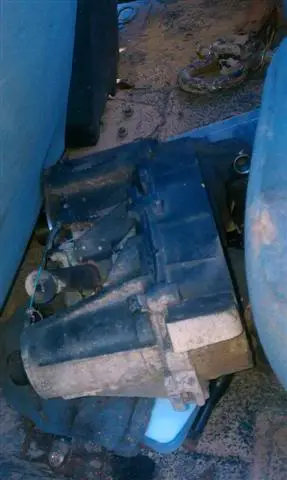

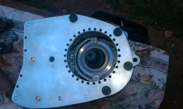

Got a 6 planetary gear set and newer style shift fork out of a newer electric 1354 to put in the 1350 doubler case. Its a lot more beefier looking then the 4 gear set planetary.
Going to check my main case also when I go to put it in and see if it has the 6 or 4 set.

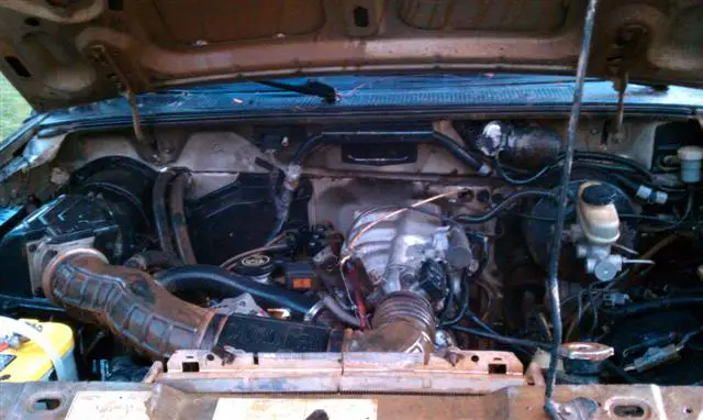

Then the idler pulley started raising hell again. Its not even a year old. I know the mud aint good for it. But I fixed it for good this time. Just took it completely off. Didnt really see a need for how it was routed anyway. Belt is still plenty tight enough and plenty of wrap on the alternator. One less thing to worry about.

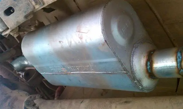

On a good note did get a new muffler from Xeek today. Got a Flowmaster 50 series to quieten it down a little bit. Going to try to get it put on Friday night.

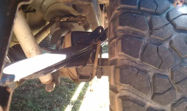

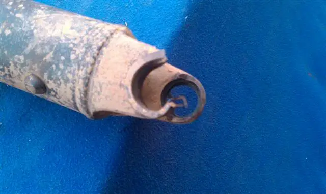

Did a little wheeling this weekend. Busted a hub and get it changed and kept on wheeling then the u bolts on one side decided to break which made the pinion angle go straight up and bound up the ujoint and broke the driveshaft.
Got the drive shaft changed but didnt have a spare u bolt so had to use a ratchet strap and limp it back home. Good thing I wasnt but about 15 minutes from home.
Also got the Flowmaster 50 series I got from xeek put on. Like it a lot better. Not nearly as loud.
...Got any wheeling pictures of where this happened...:popcorn:
...And what muffler did you have before???
