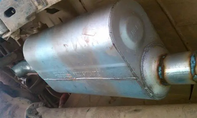

...And what muffler did you have before???
i believe he had a flowmaster 40, or at least someone did around here...
Also got the Flowmaster 50 series I got from xeek put on. Like it a lot better. Not nearly as loud.
glad you like it. it is quiet. i think im gonna play musical mufflers. swap between glasspack, 40, and none at all every now an then

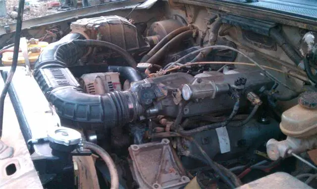

Well havent really updated this in a while but did a good bit of work to the ole Explorer this past weekend.

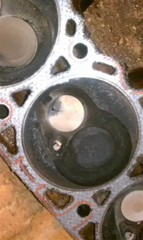

Last time I went wheeling the clutch fan took a crap and the motor overheated pretty good. Put 4 sheetmetal screws in the clutch fan to lock it up so it wouldnt over heat anymore. Believe it was a little late. Hasnt ran right since. Started pulling plug wires with it running and it had a dead hole. Smoked a little bit always too.
Bought a Explorer off one of my buddies for parts. It had a motor that had the head checked/surfaced, new head bolts, all new gaskets, new oil pump, and a few other things. Here never finished putting it in the explorer. Got 2 m5od, 1354m, resurfaced flywheel, dual shifter/boots, and a few other things with it.
Needless to say I swapped that motor in mine. Put my water pump and thermostat on that motor since there only about a month old. Got a new set of plugs and wires to go on it, and a pcv valve.
Pulled my motor out and pulled the head off to look at the dead hole and this is what I found.
Got the new motor swapped in along with a 2.9 m5od, and the other 1354m so I can use my current one for the mockup on the doubler. The clutch looked little rough when I took it off so I took it back to advance and they gave me a brand new clutch kit free of charge.

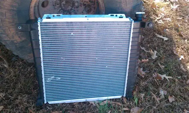

Went to the junkyard yesterday to get a clutch fan to replace the locked solid one and while I was walking around I spotted a brand new radiator so I grabbed it also.

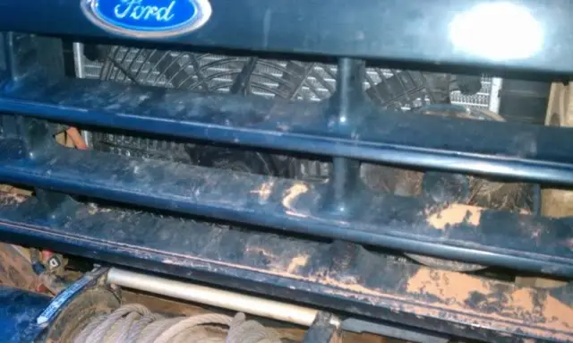

Swapped that radiator in today and put a electric fan on the front incase the clutch fan ever takes a crap again I will have a back up.
So now I should be good to go for a while now. Will have some more updated later this week so stay tuned.

Got it all swapped out in less the 24hrs pretty much. Started on it around 4 on friday and worked until about 10 and got back on it around 10 saturday and was finished around 4 or so. Then made the junkyard run. lol
Its nice when you have access to a shop with a lift, air tools, and all that good stuff.
