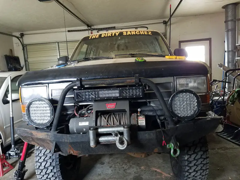

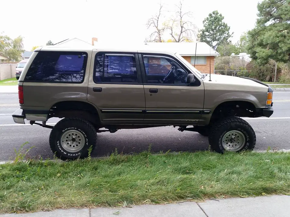

We bought it as a project and it sure has been one. We were told the engine was shot and torn apart that the transmission was newly rebuilt. I had a parts vehicle. so we got it. it was meant to be a fast 2 maybe 3 months to get it running. Swapped motor found out the transmission was shot. Did a manual swap and a manual t-case swap. Got it running in 3 months. then daily drove it worked bugs out of it. Took it to Moab seen a lot of other peoples rigs. purchased a locker for the rear gears 5.13 and a locker for the front. I have not had either installed yet. Front is a lunch box thinking e locker to match the rear. Had cut and turned beams done got some used extended radius arms and bds coils for the front and a soa done in the rear. warn winch and bumper . just need to take the body lift off now. and have a rear bumper made. way it sits now.

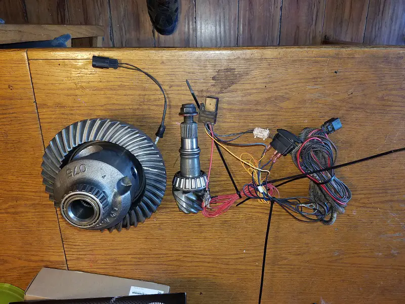

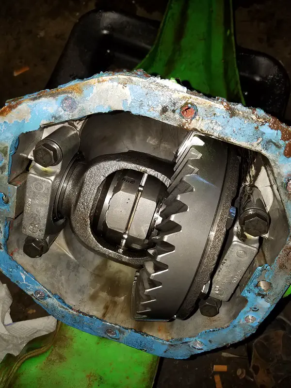

fun times been a little while since i have updated here. Finally got around to getting the goodies gathered up for doing the gears and lockers. Just need to go to the junk yard and get a second gen axle or possibly just keep my drum brakes in the rear. Finally got around to installing the ranger knuckles and brakes and alignment. Eaton e locker in the rear and a lunch box in the front.

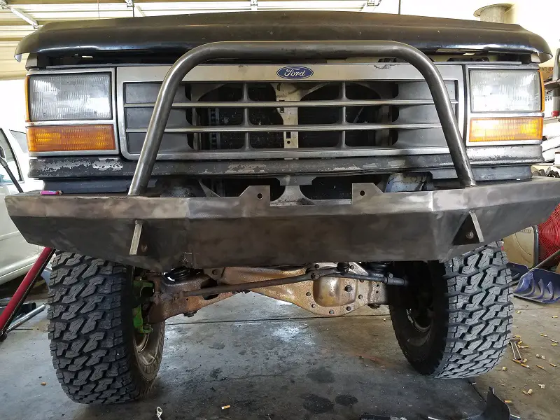

Rig looks good! You have more pics? I'm trying to get as many ideas as I can to possibly build bumpers soon...
Here is few more of the front. I had a deal with friends and family what ever name got the most votes it would be named. At gas station i get a lot of looks and pictures taken. I have removed all the nasty purple window tint as well. Took about 30 minutes to do. I have removed all the old bed liner off the bumper. A friend of a friend is going to respray the bumper with line x for 40 bucks.

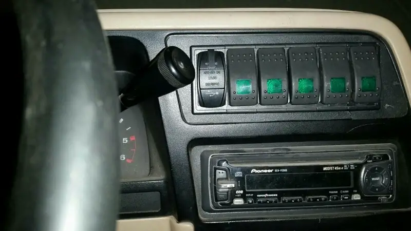

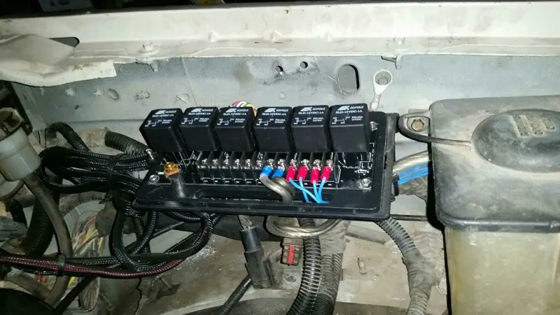

Cleaned up the wiring for lights and a few things. I was going to buy a SPOD until i seen the price. Found a generic off of amazon wiring is really clean now. I don't have half a dozen relays mounted in odd spots. it has a 3 wire hook up battery positive,battery negative and a wire going to a key on circuit. Then i gutted the JK mounting bracket and bought some abs plastic and plastic switch holders. Then I mounted where one vent and the push button 4x4 was. much cleaner with one wire loom to plug into switches. As i add more circuits just need to wire a positive and a negative to the new distribution block. Looks almost factory.

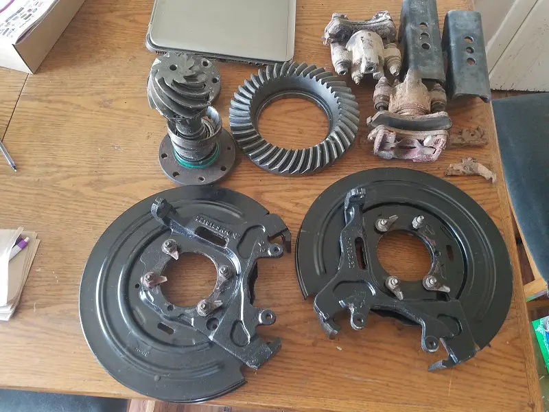

Got some more parts for my build yesterday. 4.56 ring and pinion for the kids explorer. complete rear disc swap forgot the rotors. i will pick them up when i return his engine hoist.For mine new leaf spring perches. Another axle to set my gears and locker in. Thanks again adamsbro2 you rock.
