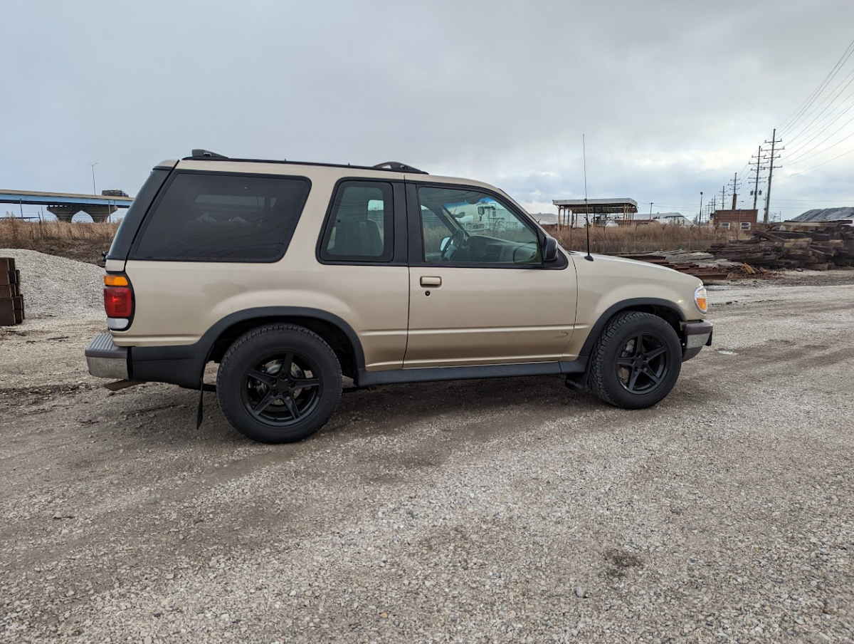

Late to the convo, but I have a little to add.
I run 17x9ET24 rims (and an 11mm spacer, so effective net offset is 13mm) with 275/55R17 tires and I'm lowered ~2" and I don't rub the UCA/UBJ or body with this setup. Your tires will be taller than mine, but at stock height your clearance would be similar to mine due to my being lowered. The one place I rubbed was on the sway bar so I extended my steering knuckle stops on the LCAs -- this may not be an issue for you since you'll have less offset and a narrower tire.
On a 17x9 with 0 offset, your rim will stick out 13mm further than mine, but your tire will be roughly 5mm narrower than mine on each side. I'd frankly be shocked if you rubbed the fender/bumper with a setup that sticks out only 8mm further than mine overall. But then again, I'm not often flexing my IFS hard like one might be doing when off-roading. With a TT, I'd really expect you to be fine. But @DintDobbs is right about all explorers being different. At some point, you just have to go with the setup you think is best for you and figure out how to make it work, likely with some combination of spacers, trimming, etc.

Thanks! I know what you mean, I built my Sport as a street truck back when I lived in the city but now that I live in the country, I want another for tow rig/farm use. That's what my "engine donor" Mountaineer is slowly turning into 🤷‍♂️
@toobladink Would absolutely recommend grabbing a second Explorer for street use. That's exactly what I did, but the environment is mean here, so a moderate lift and all-terrains for the street truck just kind of made sense.

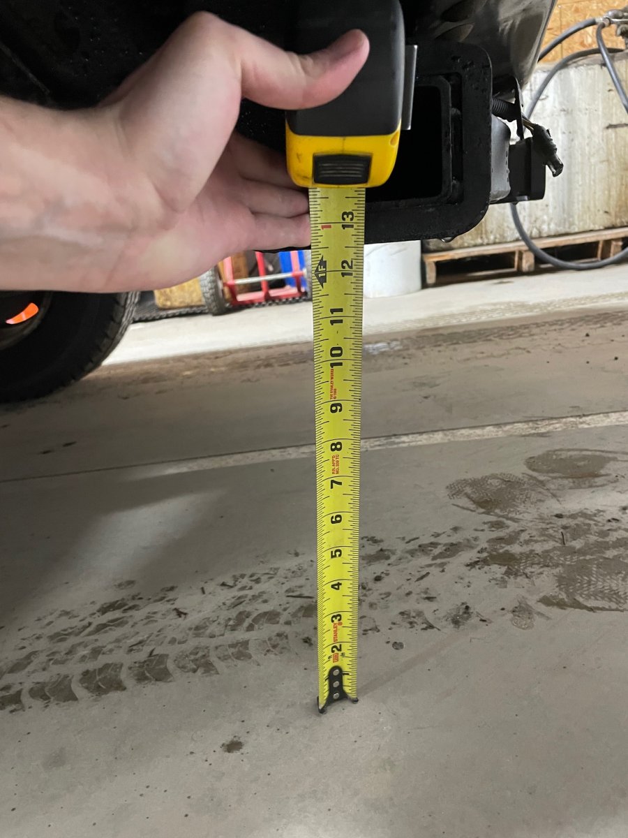

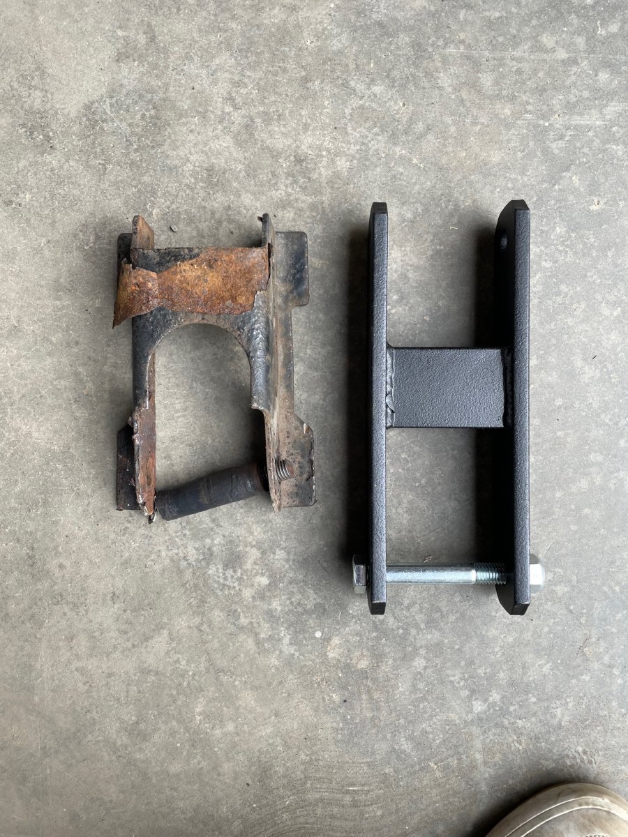

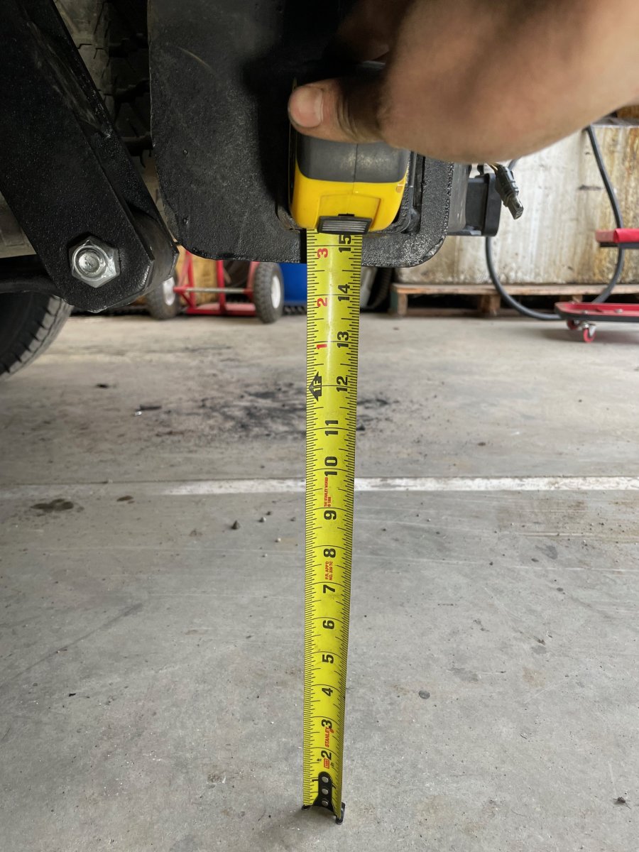

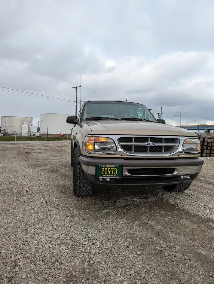

Man thank you guys for all the help. This weekend was the most amount of work, even though it was just a few things! I replace the bushings inside the frame that hold the shackles, replaced the shackles for a lil lift, and finally replaces the front sway bar links. I have decided on a new tire choice, more on that at the end. Anyways... I got some "before and afters" I want to share.
The best one is these shackles..
Yeah the old ones look really bad. Next is the sway bar links. I did not torque em down to what the manual said before the pic, so they are more squeezed down now than what that pic shows. Forgot to do that afterwards, maybe i got excited because my favorite color is green. Idk.
Okay so... let's see the car before and after the shackles!
It looks ready for the new tires I want. The biggest thing is, I broke the exhaust hanger on the back a while ago because I didn't have a lot of clearance. So I measured the end of the hitch and got a before/after of that. I gained almost two inches!
lastly, here's a pic of the new shackles. Gotta finish rust treatment on other areas. Thankfully the car isn't too bad, so once I brush everything off and treat it, I should be okay!
Anyways, I was talking a lot last week about 17 inch rims because I want (and need) new tires! I wanted to wait for the BFG KO3, but seems like the Falken A/T4W is a close competitor and they already offer it in 16 inch rims in the same size as the 17 inch. Big deal for me because I'd like to get new tires for camping this summer, basically next month - the KO3 wasn't going to be available in that size til August. lame! I also save money by not buying new wheels, and I like the OEM teardrops. So, should I get the passenger rating 265/75R16 or the light truck 265/75R16? I feel like if I air down a lot, i'm going to want the LT ones. But... am I doing enough off-roading to justify that? I don't think I am. There are big differences between the two, but I worry about the ride and gas mileage a lot since it's 8 lbs heavier per tire and the load rating is significantly higher. The rating for the passenger tire is 116T, and LT is 123S. The passenger tires I have on now have done well for almost 8 years, and I don't see myself pushing super hard, so I'm leaning towards those. What should I pick? The prices are pretty similar, it's just ride quality and mpg that I care about, but if the LT isn't much worse, I'd rather get that for the extra durability.

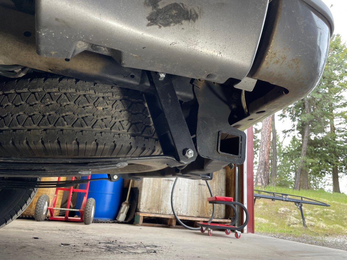

Also that last pic - there's a lot of rust forming on my rear bumper and I want to take care of it. What can I do to touch it up?
The best one is these shackles..View attachment 451984

lastly, here's a pic of the new shackles. Gotta finish rust treatment on other areas. Thankfully the car isn't too bad, so once I brush everything off and treat it, I should be okay!View attachment 451988
I saw this pic and was like "where's the bad one?" You folks out west have it too good hahaha.
When I replaced shackles on my '97 there was no sign of black paint anywhere and the steel was down to about half its original thickness. And my '97 spent its first 10 years in California before coming to the midwest! Heck, I bet a quarter of the second gens around here have at least one crumpled shackle and the rear spring eye sitting against the frame. Either that or they're one pothole away from it.
If you're taking the truck off road, I wouldn't worry about that surface rust on the bumper unless it visually bothers you. Sadly, the rust to be worried about is always the rust you can't see: inside the frame, inside rear quarters, inside the rocker panels, and inside the front fenders at the bottom where the inner structure welds on. If you don't have rust there now, it'd be a good idea to spray fluid film or something in those areas for protection.
The rust-slowing formula I like for exterior and suspension parts (and have found holds up to time and harsh conditions) is rust reformer then chassis paint then bedliner. The key is getting the surface clean before the rust reformer goes on. The bedliner really helps make debris bounce off so you don't get new rock chips and start rusting again -- I even have the non-visible sections of the rockers on my daily driver sprayed with bedliner. If you don't like the bedliner look, you can always skip and topcoat the chassis paint with your color of choice instead.

Yeah the rust on the bumper just bothers me, especially because it’s gotten significantly worse since the winter. I’ve been using rustoleum rust reformer on the frame and anything steel wherever I can as I slowly work on things and expose them. Probably going to do the majority at some point in a few weeks and then I’ll probably spray with something else for protection. Just been doing the rustoleum reformer because if I waited for that to cure and then paint, and then waited for that to cure..I would be waiting for paint to dry and not really able to work on much of anything lol.
Have you tried rustoleum before/can you compare? I think the rustoleum one is similar, it smells different than other spray paints and I've had to wear a respirator when applying, so I feel like some sort of similar bonding is happening lol.

I will probably try it anyways. I've only found the rust reformer in the spray can and it's nice, but man the can gets messy. A brush would probably be faster, too.
My front bumper here was solid rust for a couple of years. Last season after washing my bronco I was tired of looking at ol rusty duff
Bumper. So I coated it w the permatex 2 coats. That’s it no prep no sanding nada
Here it is today still solid black no new rust
I live in the mudd and dirt and drive her in the winter salt
So if I sand the sucker and then treat it followed w some paint it will be like new again
The permatex works
