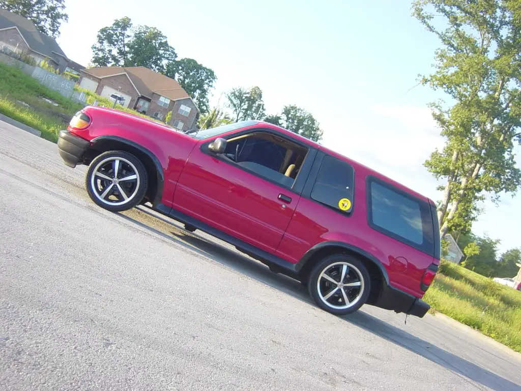

^^^^^^^I tried putting 04 cobra wheels as well as 07 shelby wheels and neither would fit on the front due to the hub, my explorer is 2wd so the hub for some reason must be bigger then the rangers and 4wd/awd explorers. but idk. maybe im just crazy, or someone before i bought this thing put aftermarket rotors on it and thats the problem but then again it can cause the stock wheels fit. I'll measure the hub when i get to work and find out what the size of the hub is. should be 70.3 or 70.5 i think.
BTW what size tires are you running i was thinking of getting these wheels

Cheap rotors are not cast and machined to the EXACT specs when it comes to hub height (depth?) I have heard of people having to cut .0625 -.125 off the top of the hub (where the dust cap installs) to get the cheap rotors to fit.
But I guarantee that they SHOULD fit....
My tires are 255/55-18 up front on 18x9 Saleen (replica) Rims, and out back I have 285/50-18 on 18x10 Saleen (replica) Rims

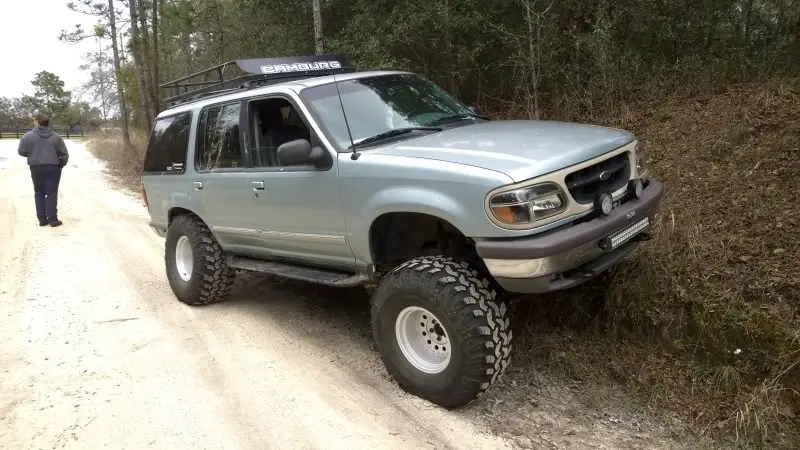

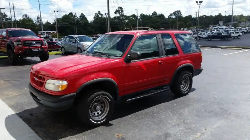

Correct. thats all you need. well im back with a 96 red sport and it will be lowered. i gave up on lowering the green 96 that i had asked questions about. it has been converted to 4wd and lifted 7 inches and rolls on 36 inch tires. now on to the lowered explorer. im thinking maybe 2 inches. seems safe that way. it kinda site low as it is now. will post pictures later. the front end needs work i found a limited grill that it going to get. I may look for a street appearance package bumper from a ranger. what do you guys think? and possibly the wheel i talked about last time.
