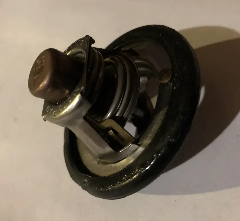

Old thermostat was stuck open.
New one went in pretty easily, so far no leaks.
Temp gauge is working again, heat is blowing hot again.
While I was there I noticed drivers valve cover leaking oil, tightened up the bolts, they weren’t that tight. So hopefully I solved a few problems today.
Bingo. It had overheated, that is a Motor Rad thermostat. I have that in my 99 SOHC, I tripped it twice in six months. The thermostat can be fixed, it was tricky to crush the spring and retract the tangs to let the spring go back where it belonged. I drove in Winter with one of those, on highway it wouldn't get much above 105*(the coolant).

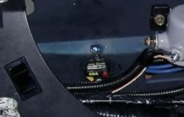

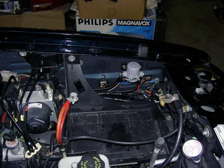

I don't know what the trigger point is for those, but I suspect it's around 250* or so. I hit 270 as seen on a Scangauge device, and 282 the 2nd time. Mine were unexpected, my electric fan relay tripped when I washed the engine, and the next day at work I noticed a very high idle. I caught it, I had the Scangauge on all of the time. Shut it down, fixed the relay, and added about two liters of water. Later after R&Ring the thermostat, I had forgotten to add anti-freeze to get proper ratio, in Winter the radiator froze. I got to work and after a couple of hours had to add less than about 15oz. No harm luckily, but it was my fault for not checking the anti-freeze, and that morning we hit about 4*, it was 9* at my house when I left. I usually have my ratio set for about 0-10*, which will work if you keep it at that. But I wasn't there, cleaning the engine was a mistake that Fall, and the "marine" relay wasn't water resistant obviously.
