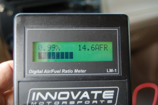

A/F test results
I wanted to determine the A/F ratio while using HHO in my truck (1) at idle (2) 65 MPH highway cruise and (3) WOT ( short burst only ). I have this data from a previous test of this particular PCM tune without using HHO for a comparison.
Note: this PCM tune is forcing closed loop operation from start up and has a good delay before switching to open loop at WOT. This explains why the WOT readings are what they are. In the short run at WOT, the trucked stayed in closed loop.
Without HHO:
(1) Idle – 14.7
(2) Highway cruise 65 MPH – 14.7
(3) WOT – 14.7
All of the above readings are rock steady
With HHO running
(1) Idle – 14.5-14.6
(2) Highway cruise at 65 MPH – 14.4-14.6
(3) WOT – 14.4-14.5
All speeds GPS determined. All air/fuel ratio data determined by using an Innovate Motorsports wideband LM-1 A/F meter (http://www.innovatemotorsports.com/products/lm1.php ). The operation state ( closed/open loop ) was determined by OBD II scanner.

Aldive, just so I am clear your A/F before HHO is 14.7 which is pretty much optimum but after is 14.6 or less this means your running fat (over fueling). That doesn't sound like it is helping but this is the predicted result correct? I have read through the entire thread trying to catch up everything discussed so far.
Another thing the oxygen sensor monitors simple oxygen (O2) and not the compounds correct? All the readouts counter what the HHO should be doing. (i.e. lowered A/F ratio because of increased exhaust oxygen = less fuel burned)

If the difference only amounted to a tenth of a point or two, there is no problem. The worry is that with a usable amount of HHO gas, the A/F ratio might end up 2-4 whole points off.
Actually the A/F will not be off by 2-4 points. The PCM will adjust such a lean condition and add fuel to try to reach 14.7.
This will result in no MPG gain or maybe a loss in MPG.
