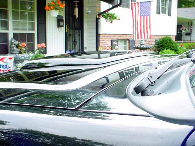

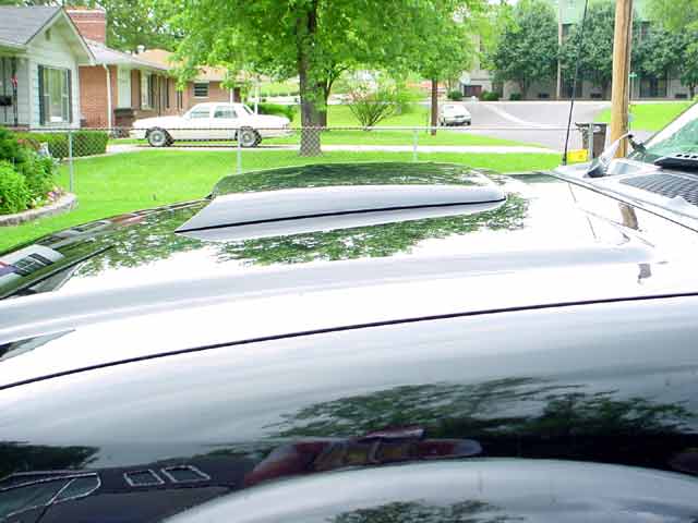

Now, I may be biased, but... I think the one on mine looks great from a distance and close up...
Mine is a cowl type scoop. Doesnt fit perfect, but only I can tell that.

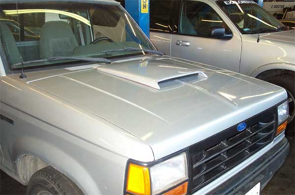

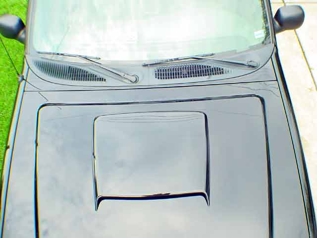

John would that mustang style one fit a first gen, and is that almost the same as blackmagic's?
Yes that one is like Black Magics.
It does fit on a gen 1 as is if you slide it all the way back. If you notch out the the back of the scope for the body line you could move it forward.

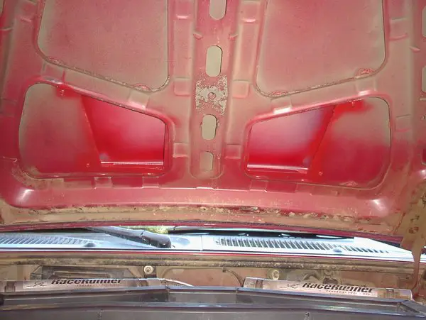

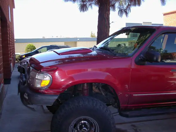

I also found that to be the case. Luckily I measured twice before drilling. I ended up putting the scoop on its top, tapeing the template over the bottom of it, and pushing screws through the template where the pilot holes really were. To be a little different, and in my mind, more functional I put my scoop on backwards, and made it a functional cowl.
