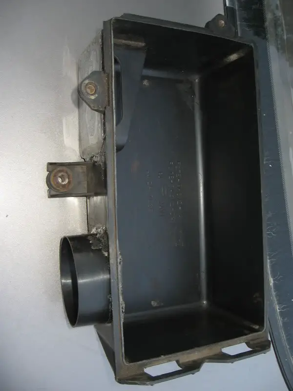

i used a 3"-4" drier vent reducer and factory air box.

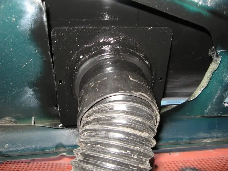

here's were it goes into the scoop.
i used a drier vent cap and glued it to the scoop

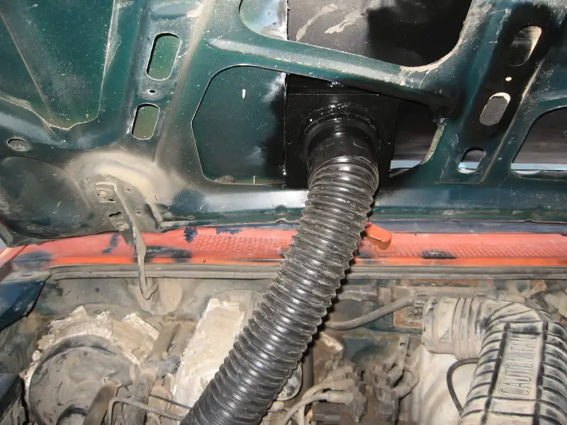

here's the completed setup
you can hear it going down the road. :D
very nice! one of the only ppl i've ever seen actually make a scoop work, just watch out if it rains
haven't had a problem with the rain.
it was funny though i was running in the dunes and went thru a water hole and the windsheild fogged up.
