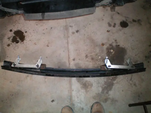

After all of the body mounts were tight and trim replaced we focused on the bumper brackets.
The front one was great out of the kit, just a bit of grinding to make it fit.
But the rear bracket was useless, So we made that from scratch at my friends machine shop.
