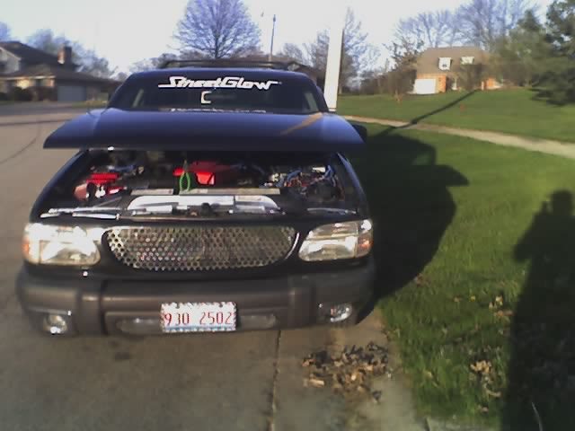

RESULT: When you open your hood, it opens normally, BUT, you can then grab the top, and fold it down (It wants to fall on its own because its so heavy, get a support). Your hood liner actually hides the hinges about 98%, when its up normal you wouldn't even see them. When it folds down, it slightly bends the hood liner, but only a little-no creases) Perfect for car shows, or just someone who wants to show off. This is the first day I have had it, and already I have received comments from just about everyone in my school! The stock hood latch on the hood, actually rests on your radiator cover thing, so it is already supported.

Pics for ya'll
See, hidden 98% of the hinge:
http://i58.photobucket.com/albums/g278/Airsoftplaya16/04-20-07_1840.jpg
Strap hinge bolted onto hood hine, then back of the bolts shaved off:
http://i58.photobucket.com/albums/g278/Airsoftplaya16/04-20-07_1844.jpg
Strap hinge is bolted onto the hood support beam (the one that sticks out):
http://i58.photobucket.com/albums/g278/Airsoftplaya16/04-20-07_1843.jpg
See, the hood rests on the radiator shroud thing:
http://i58.photobucket.com/albums/g278/Airsoftplaya16/04-20-07_1842.jpg
Cant really see it, but its a back shot:
http://i58.photobucket.com/albums/g278/Airsoftplaya16/04-20-07_1841.jpg
Show room shot:
Show room shot #2
http://i58.photobucket.com/albums/g278/Airsoftplaya16/04-20-07_1847.jpg
