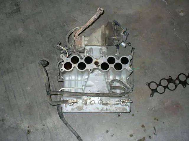

going much smoother than planned.
1.5 hrs to get the manifold off.
Question (next pic); what hose goes here? I did not remove it, but once I was able to start pulling the manifold up I looked and did not see a hose. Where does this one go? The other end is the T and PCV.
Crack in the gasket? Possible cause?
I know the engine won't be shiny clean, but does this seem like an excessive amount of carbon build-up? Considering the truck has >188k miles on it.
Also, Fel-Pro are the most recommended brand of gaskets, correct?
Also found the source of the exhaust tick. Gonna try and "repair" it with some steel-epoxy putty I have left.

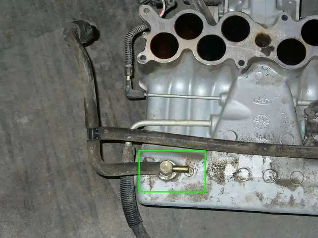

Ok, so this has to be and have been the problem.
Got the manifold reinstalled with new gasket, bolts torqued down properly, and all vac lines hooked back up along with PCV.
There are no hoses left to connect to the fitting outlined.
What goes here?!
I never removed a hose from this spot, it did not get pulled loose when I was pulling the manifold off, and there are no loose hoses left! :banghead:
This is the rear driver's side.
Put a cap on it--
some have caps there, some have another "t" fitting which splits it again into the pcv--brake booster line. Your original backfire probably blew it off. That was the source of the hiss I bet--
OK the crak in the upper plennum combined with the cracked egr tube cold have definitely cause an intake backfire upon start up. This could easily blow the cap off, making the leak worse.
You really need to get a new egr tube. any kind of steel putty will melt, it gets about 1100 degrees there.
