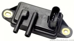

I'm looking on RockAuto at "EGR Pressure Feedback Sensor"
this would be the DPFE, no?
Where exactly is it located? Or where it's plug be?

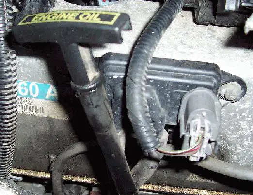

It looks like this. It is kinda hidden behind the intake, however it is on the same bracket as the egr vauum solenoid. This one is on a v6 though so ignore it's surroundings
thank you! I pinpointed it quickly, and verified that I did, in fact, not reconnect it :) :rolleyes:
