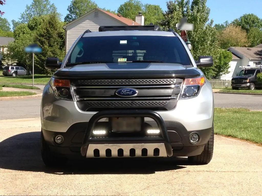

For much less money than a trip to the dealer, I added Philips DRL 4 LED lights. In my opinion they are brighter and look better than the amber lights.
@dmlns1092: Even though that looks VERY nice, that solution will not work for everyone.
On Explorer's equipped with the forward collision and adaptive cruise control the area (see photo) you covered with the lights and front bar needs to be clear of obstructions for it to function properly.
I think it will work fine. I believe the radar unit is behind that solid black plastic part on the driver's side and not behind the open grill area. You could also go with two of the 8 LED strips and sort of have them side by side.

dmlns1092,
How was the installation on those LED lights? I love the looks of those, I'll probably buy them if the install isn't too bad.
Very easy and I'm no car whiz. They're literally plug and play. Once hooked up to your battery's extra connection, you feed the wires through to the opening. I was nervous about drilling the brackets, so I used heavy 3M double sided tape used for outdoor use. There is also an additional wire you hook up to your parking lights if you choose. I did not hook that wire up so they stay on when I turn on my lights.
