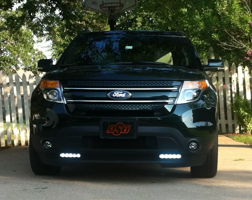

I would not call this a quick installation. I had to fab up brackets to hold the drls behind the bumper valance. The brackets that came with the drls were a joke. The drl's are attached with 3 screws (2 lower and 1 upper) and are high enough up on the bumper that they feel pretty solid. I used drls that had a rake to them that matched the curve of the bumper pretty well. I used a $15 drl wiring harness (ebay also) for proper functionality of the drls and clean wiring.
Here's a close up of the drls just peeking through the valance. Yes I fretted over cutting the holes, but this is a $100 part, so its not a big expense to replace if I want to go in another direction in the future.
Here's the back side of the valance showing the bracket attached to the bumper.
Here are couple of pics of the bracket. You could probably say its over built. I used extruded aluminum angle bar. Easy to work with and weather proof.
Added trim around the drls to finish the look
You can tell the difference which one is cheaper, too.
