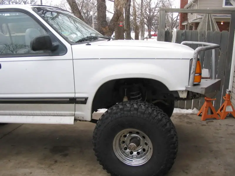

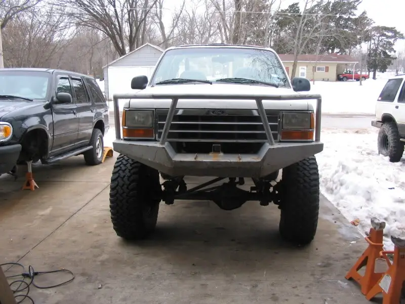

I had intended to powder coat the bumper before installing it, however it was just in the way. I couldn't think of a better way to store it than this.
You'll notice the lower grille valance hanging on the fence.
I need to adjust the bumper a bit but it looks good on there. Better than tripping over it
Um,,,aren't 'bow pulpits' supposed to be stainless steel? At least all the ones on the sailboats I have owned have been. :D
And where are the life lines runnning down the side?
That's what ya call a DEER CHUCKER!!
