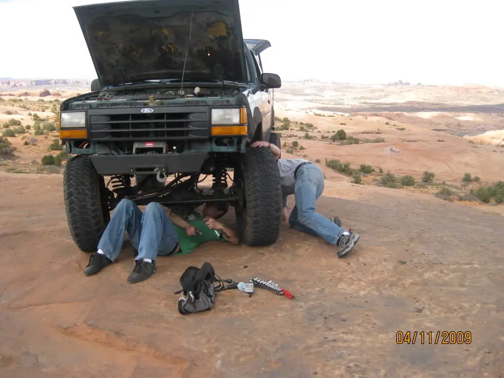

That is seriously funny. I just got back. Guess whats broke?
Motor Mounts!!
Pics and details tomorrow. I think I need to do a motor swap!

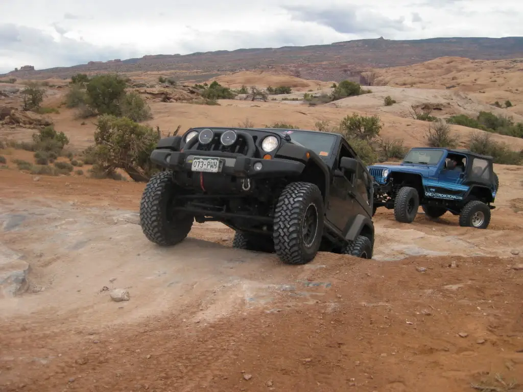

The Crew:

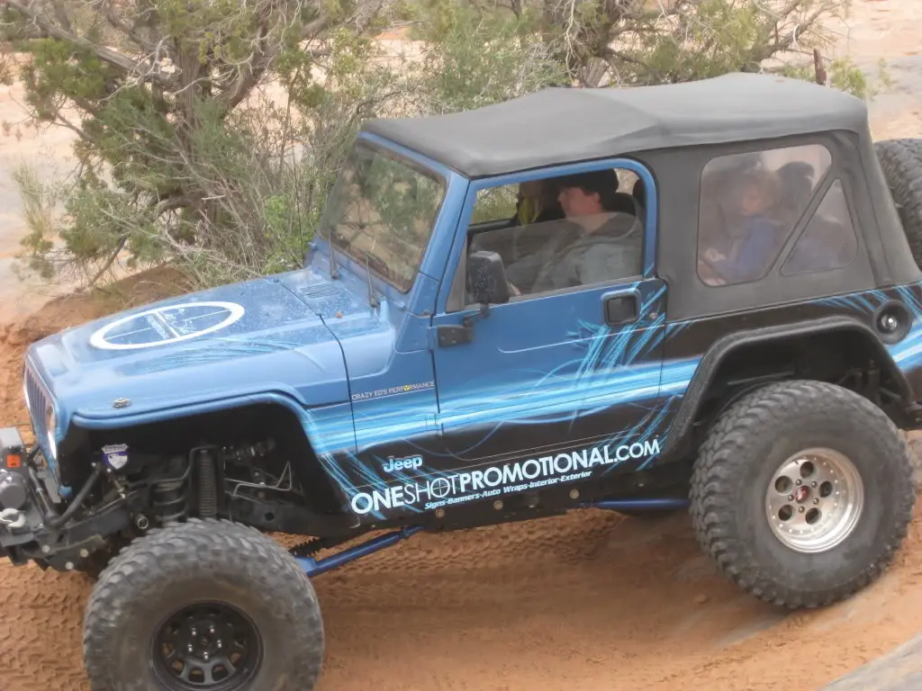

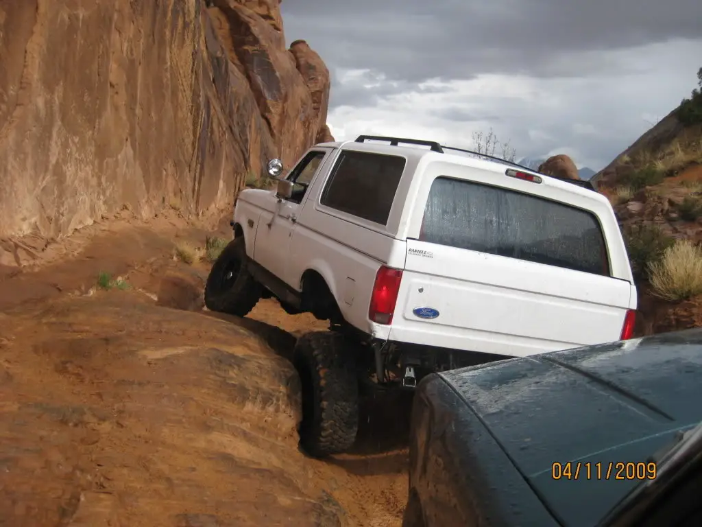

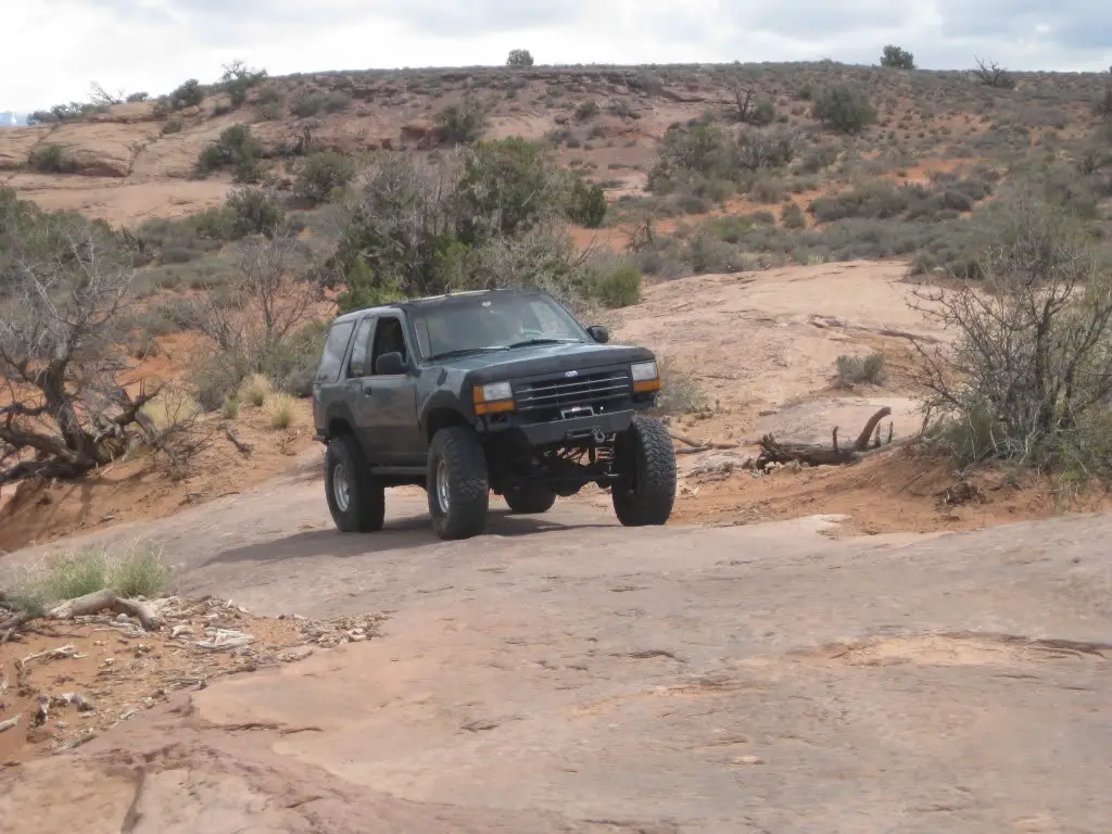

Brents JK, Matts TJ, Phils Bronc, My sploder:

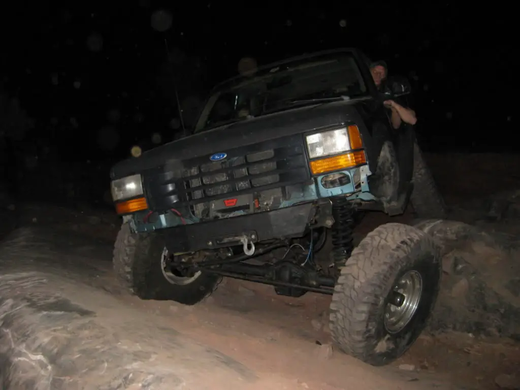

2 AM Moab Rim Run:
I never want to do that again, especially in the dark. I thought my truck could handle it better now, but wow. Scared me again! Phils bronc almost ended up on its top. Really close. No pics of that! We were all scrambling to get it back on all 4s!

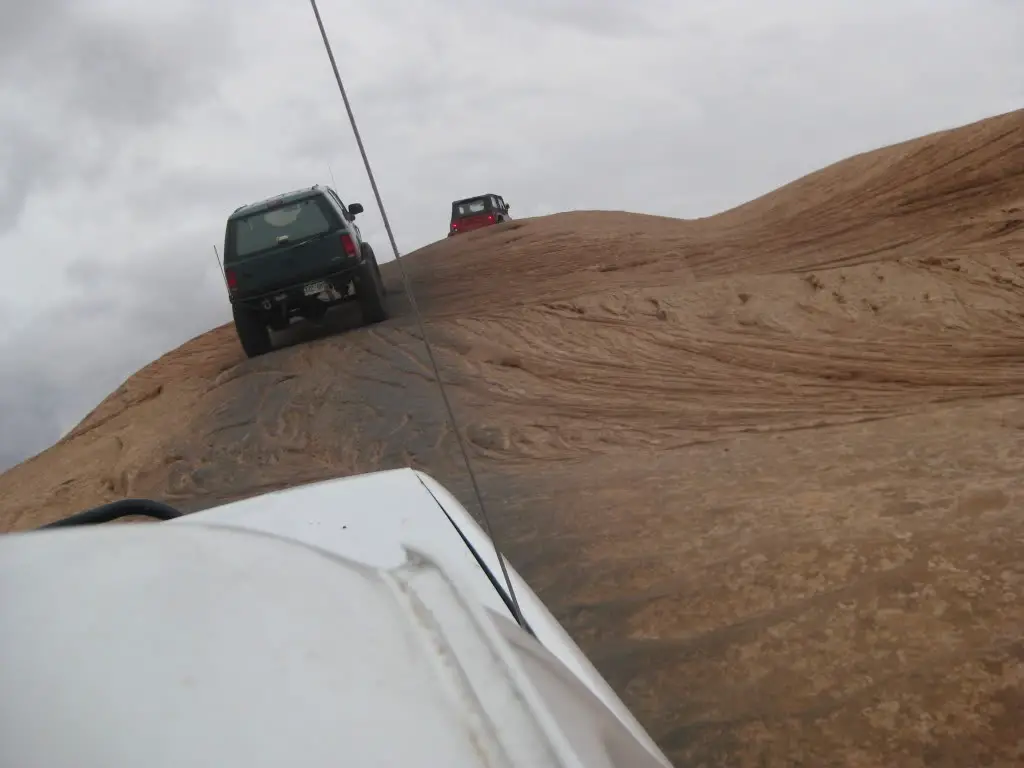

Hells Revenge:
