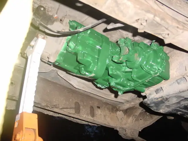

I didn't clock mine. For some reason I thought the driveshaft would hit. If I tear mine apart I will probably clock it so I can gain another inch of clearance. If I remember right I had to rearange the floor with a 3lb sledge to make it fit.
I clocked - but you'll notice you only need a few degrees because of the transfer case's shape, the bottom is a very wide "V". So the important thing is to only get the bottom of the V above the belly.
Sweetness. So the consensus is clock it one click. I will give it a shot. Thanks for the input. To echo IZ's input, I really don't think it needs much to be flat. It barely hangs down as it is. I do have some serious battle scars on my tcase skid though!

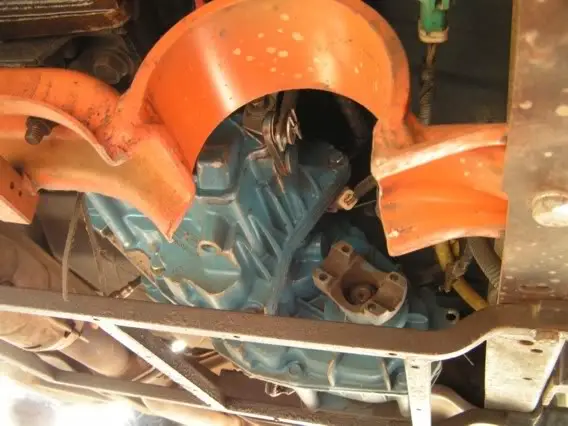

Here are firezappers pics with a stubbler and a trimmed tcase/ Gas skid:
After a close study of Firezappers pics, I am now thinking it may be possible to leave the bolt in the front skid support closest to the frame and cut the front inner corner off the skid. Then I can leave the skid where it is at and maybe offset the tank straps move the tank only back 1". Hmmm. Now you guys have me thinking. As soon as my little girl goes to bed I will start pulling down the tank for a closer look.

OK now you have me thinking. I got the skid trimmed and it looks like I got maybe like 1" more maybe less than firezappers setup. From his pics it looks like the top is the issue more than anything. So jaime has me thinking. Anyone know if there was a metal gas tank on any of the sports? I could hammer out like one more inch and be good if it was metal.
From what I can tell from others' post on here it looks like the late model sport tanks are not as long and metal??? I can't find any solid info on it.
I did, however, see that cheapthrills said he mounted up his homebuilt doubler in his sport by cutting off the front of the skid. I am going to mount the tank back up and go with it until I get there.
As far as I can tell it will be nearly impossible to move the tank backward. I would have to move the crossmember that goes down the middle of it. That looks like it is all that would stop me.
