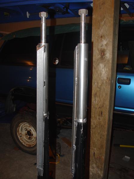

Welded up my radius arms today, well a friend welded them for me, since I`m not the greatest at that yet, but anyway..
The bent and twisted people I got the arms from suggested welding a piece of flat bar on edge on top of the arms to reinforce the structure. I opted for 1 inch angle iron, which is probably stronger, and looks better than flat anyway. Just painted `em up again and will mount them sometime this weekend.

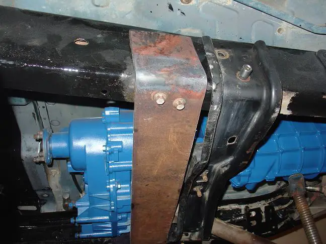

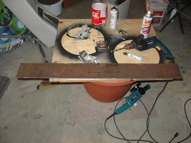

Started building my radius arm/tranny mount bracket recently, and since I got no cash, I`m taking my time with the cheap stuff.
I started with some 1/4" plate steel, 42 inches long and 5 inches wide.

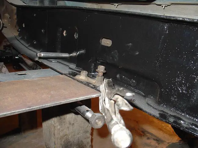

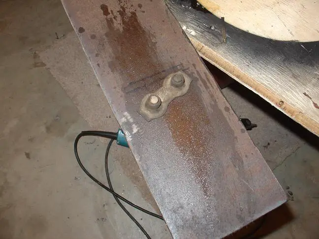

I centered it across the frame, resting up against the stock tranny mount, and I marked where to drill two holes per side using some leftover bolts and double nut doo-hickeys from stuff I removed from the truck previously. LOL I just can`t remember where they came from exactly, but whatever!
Once I had the locations marked in felt, I took the plate out from under the truck and drilled the holes, making sure they still lined up with my double-nut doo-hickeys.
the pics are from the passenger side, I staggered the bolt holes to miss some reinforcing metal inside the frame, not really neccessary to do that since it won`t be bolted there when the bracket is complete, but I wanted to bolt it tight while I bent the plate.

After I had the holes in the plate I butted it back up against the tranny mount and drilled the holes through the frame, using the plate holes as a guide, obviously.
Then I bolted it in place and heated up the bend area with an Oxy-Acetyline torch, then hit it with a really big hammer until it was bent. When it was close I squeezed it tight to the frame with a C-clamp and heated it again, leaving it to cool before removing the clamp. Afterwards, the bend was perfect.
Then I took the bracket off for reinforcing. Also, instead of bolts in the place I drilled the holes, there will be pins, or steel dowels welded in place. These will serve to keep the bracket in place for bolt up and keep it from shifting. The bracket will be bolted higher up the frame. I can`t bolt it under there because of the final radius arm position.
