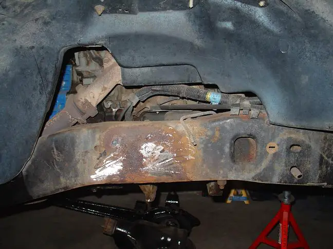

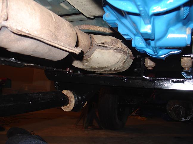

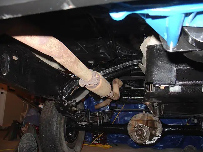

Got my exhaust back in.

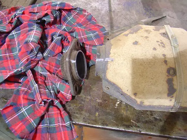

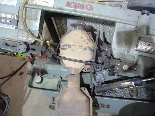

I had to modify my cat system to fit above the bracket. The stock configuration has the second chamber at an angle, so I cut it and turned it flat..
I didn`t realize at the time that I only really had to cut between the two sections, the cut in the first pic is actually redundant because it doesn`t matter where that flange lines up, the connector allows you to spin the exaust to wherever you need it. If anything, it will decrease under truck wind resistance, allowing me to wheel faster. Good practice anyway, and the whole proceedure only took about 45 minutes.
I`ve been doing all my own welding since after the radius arms were done by a friend. I guess I didn`t have the confidence, I`m no expert but I did pretty good on the radius arm bracket, and now the cat.
Anyway the pics tell it all, so look at them!

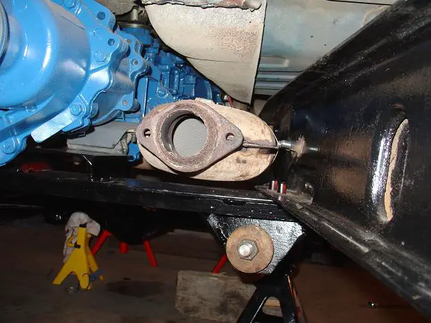

Eventually I got the whole exhaust in and started the truck to let her run a while..
If it looks funny, the muffler was from a local shop, something called a "spinner". It was cheap when I got it so whatever.

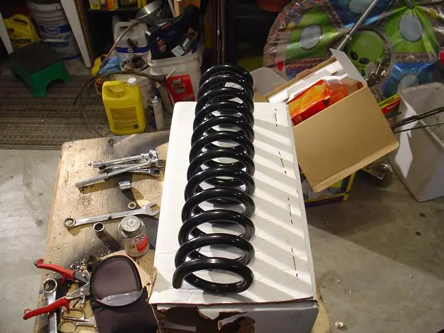

Ended up ordering a set of 6 inch lift coils locally from a company called BDS, for a 79 Bronco. Too much hassle to try and get some of the more often used brands on the site here. I`ll have to figure out how much the Ex will compress them next.

Lookin good so far:thumbsup:
I think those full size Bronco coils are going to be pretty stiff on the Ex. Does BDS make coils for an Early Bronco? Those should work better as far as spring rates are concerned but rock em if ya got em:D
Damn, you got the wrong coils. Now you have to do a v8 swap to add extra weight. :(
:D
Alright I feel dumb, take your shots, ya vultures!
one slip up among a greatly detailed build....who cares.....you make up for one slip up with the rest of your build......
Haha, we've all been there/done that. :p: I dont think you can put enough weight on the front of your X to run those. I know you can swap stock 79 Bronco coils into an early Bronco and it gives about 3" of lift. Considering the coils are about the same height, that should give you an idea of how stiff they will be.
:D Tunnel vision, I been so focused on 79 this and that that I never even gave it any thought.
Anyway, that`s why it`s good to share here! I should be able to get some new springs in by the weekend...

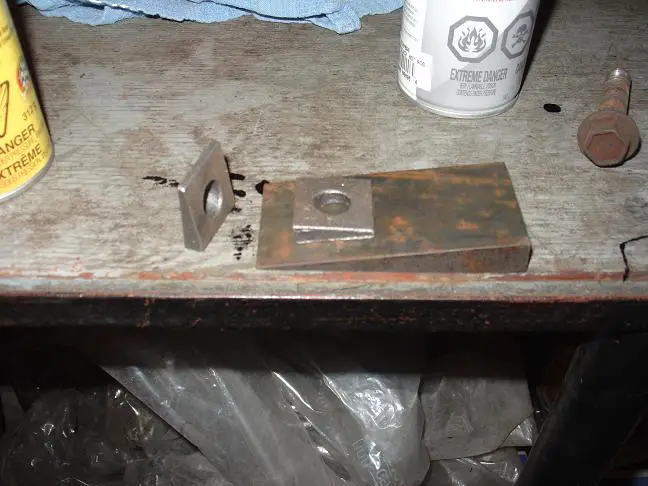

I had the local machine shop make me some shims to go under the coils seats, they are about 8.5 degrees. For the top I needed a way to ensure the bolts are sitting straight, so in lieu of another shim, it was suggested I use some angled washers that are used in the construction of steel structures. Specifically, they are used when bolting large channel or I-beams together. The channel is angled inside to about 8.5 degrees.
