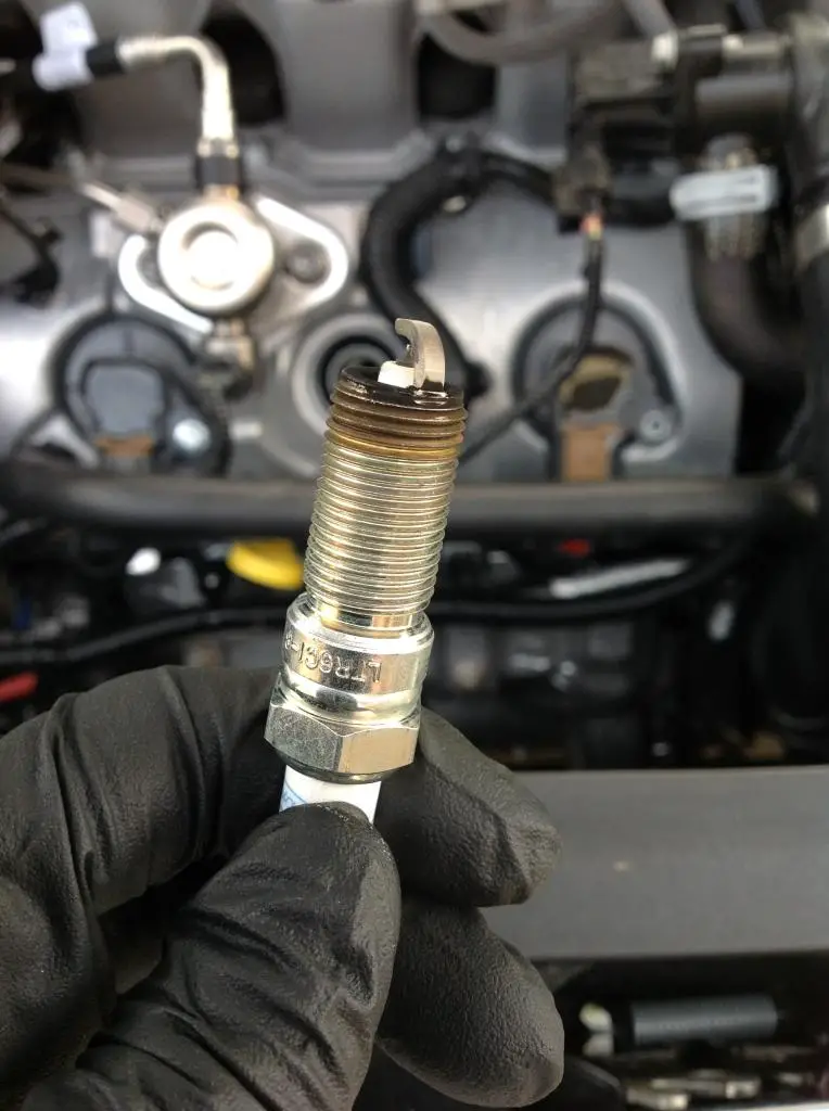

I may have found out what was causing my stumbling and misfire issues. Pulled the plugs yesterday and found this on the rear right 2 plugs.
Both of these coils came out saturated in oil. The spark plug was submerged in oil all the way to the top. I would go out on a limb to say that this isn't normal. Lol:eek: Guess we'll see what Ford thinks about this.

Will do. I'm going to have them pick it up at my house on a roll-back and haul to the dealership. Not sure if this issue has been present since new, but I've had the stumbling since new. Funny thing is, it's not threw any lights or codes. Vehicle only has about 4200 miles currently. Can't wait till Tuesday. I wan to see the tech's face. :D
Here's what the other 4 plugs looked like, except for the 2 in the oil bath.
Submerged in oil would definitely cause a misfire. 6 million dollar question is where did the oil come from. Valve cover gasket would be the only possibility I could think of unless the oil change tech had really poor aim lol....
