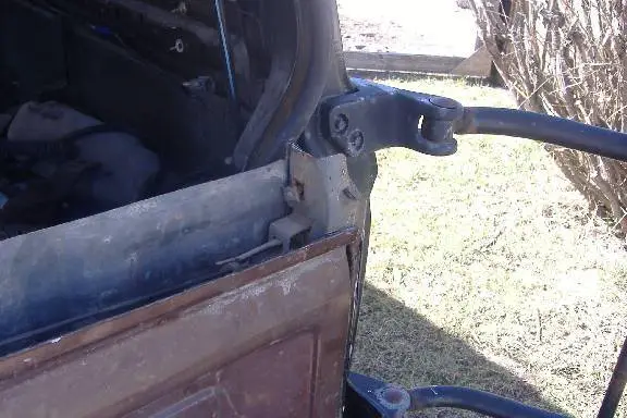

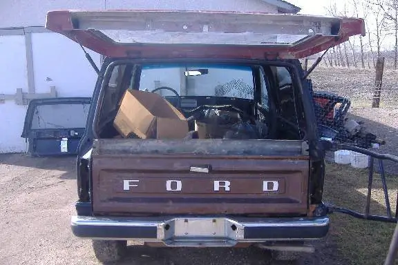

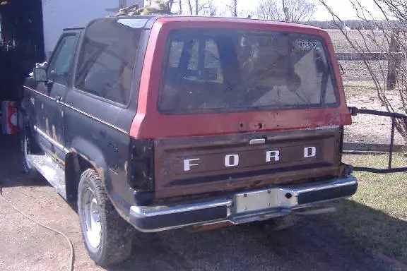

Anywho... so DB_1 donated is old tailgate off his '97 Ranger with all the hardware (Thanks Dave)

I will use the mounting hardware only( hinge) from the Ranger gate. I will also most likly use the limit cables. I plan to still use the factory Explorer latch. this will allow me to use it just like a tailgate with the handle.

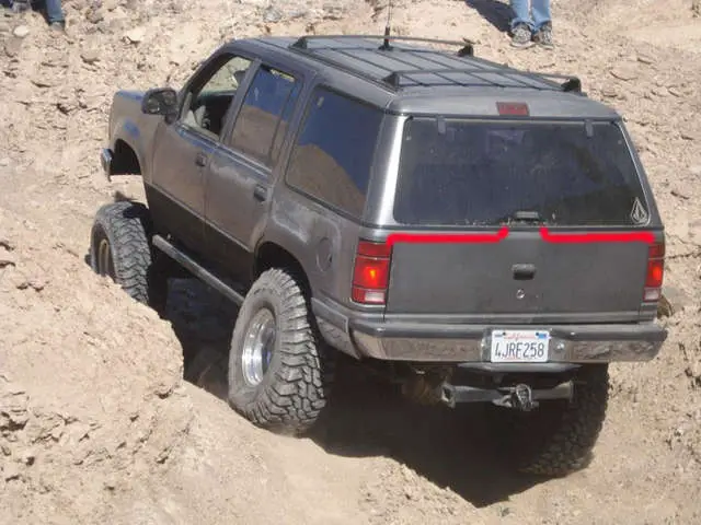

Using tbars truck as a Exsample (Thanks Ted) I would probally cut on the red line. Sealing the rear glass some how and using everything as is to speak. A 1st and 2nd gen would work the same. Maybe using a piece of plexyglass instead would work better, but the curve of the glass could be a issue.
