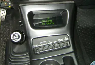

A few on here have heated it up and bent it in slightly. I think that is how Hokie did his.
On my Ranger, I had to heat and reshape the side of the console quite a lot to make the two fit together. However, that is a little deceiving because I also moved the linkage in a bunch on the transmission and offset the engine/transmission/transfer case slightly to the right in the truck. Both of those changes together moved the t-case stick over an inch closer to the console.
On the other hand, the stick may hit the inside of the F150 shift boot and bezel if it isn't moved over. The original F150 trans tunnel (where the boot/bezel was intended to mount) is wider than a Gen2 Ex or a Ranger.
http://www.explorerforum.com/forums/showthread.php?p=1752089

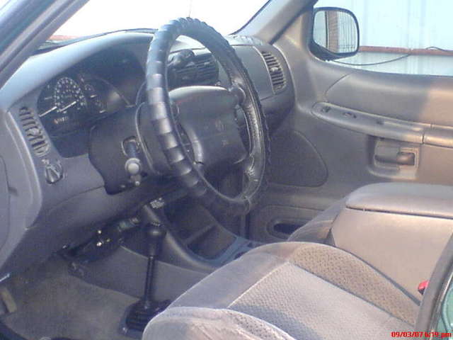

We bent the shifter linkage lever, not the console. The first time was for perfect clearance in a stock vehicle, the 2nd time was after I added a BL 3 months later. Not that big of a problem either way. We chucked the linkage lever into a vise and slipped the jack handle over the end to get the right angle. It was a compound angle, kinda back and away if that makes sense.
I've got no body lift and don't have any problems with the shifter, un-modified. I still don't have a shift knob on there though. I think a sweet pistol grip style out of an 80's Camaro would look slick.

With ~2.5" Body lift:
You can see what I mean by "back and away" when we bent the shifter. While driving, I can rest my leg against it if I want to, but it never gets in the way. I did this so I could wrap my fingers around the knob without hitting the console. Boot cut pants will sometimes pick up a little vibration from the shifter and send it up your leg. It was really weird until I figured out what was going on ;)
