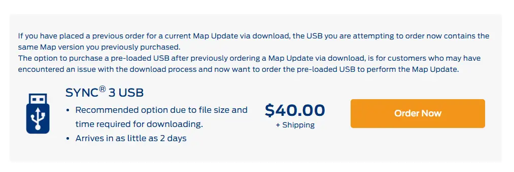

Folks, I'm still at version 19 and was trying to download ver 20 but it asks me $40 for the USB stick and I dont see free download option anywhere. Did Ford changed the policy and maps are no longer free?

It's done OTA now. Takes a while but it is free. You do need an internet connection for it.

BTW, you didn't mention which Sync V3.4 build you have. The current build for V3.4 is 21098. The 2.20 map downloads appeared to begin OTA after 21020 downloaded. If you don't have an Internet connection, you should be able to at least download the latest Sync software from your account,

I just downloaded 21098, will be installing it later today. So hopefully post that 2.20 map should download via wifi. Thanks Peter and Dale5403

Just a few things. After this SYNC updates can be done OTA also. You most likely will have issues with Travel Link also. The latest news is the next SYNC update should have the fix for that. And the map update has a number of files to download and it does take a long time. Good luck with it.
