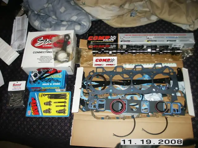

Well got some parts in today. Or was it yesterday...
Heres the rods, gaskets, head/water/timing/intake bolts, bump stick, and plastigauge.
Unfortunately the set has cork valvecover gaskets. i may ditch those and get some steel core with bonded o-rings like the ones i took off.
