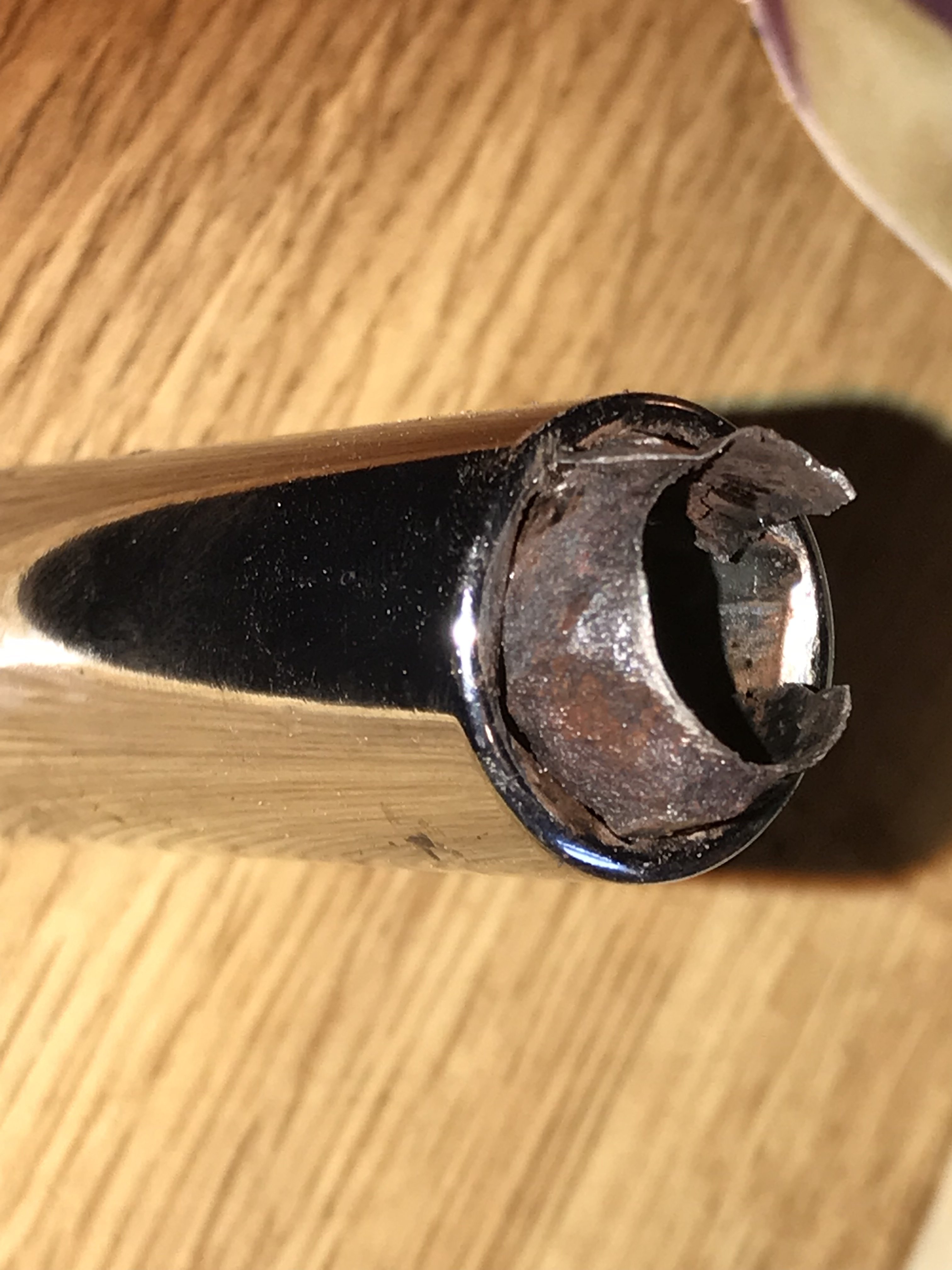

tried to get the plug out and.......
Well, there's your problem. I would expect all others to be like that. while you are at it get 8 autolite double platinum plugs. dislike for all other brands runs deep here.
It'll come out, just do not get angry with it. Carefully vacuum out all the bits you can, spray the remainder well with pb blaster ( not wd40) give it a few minutes to work and try the easy out. You should have a hole in the center of the plug to work with.

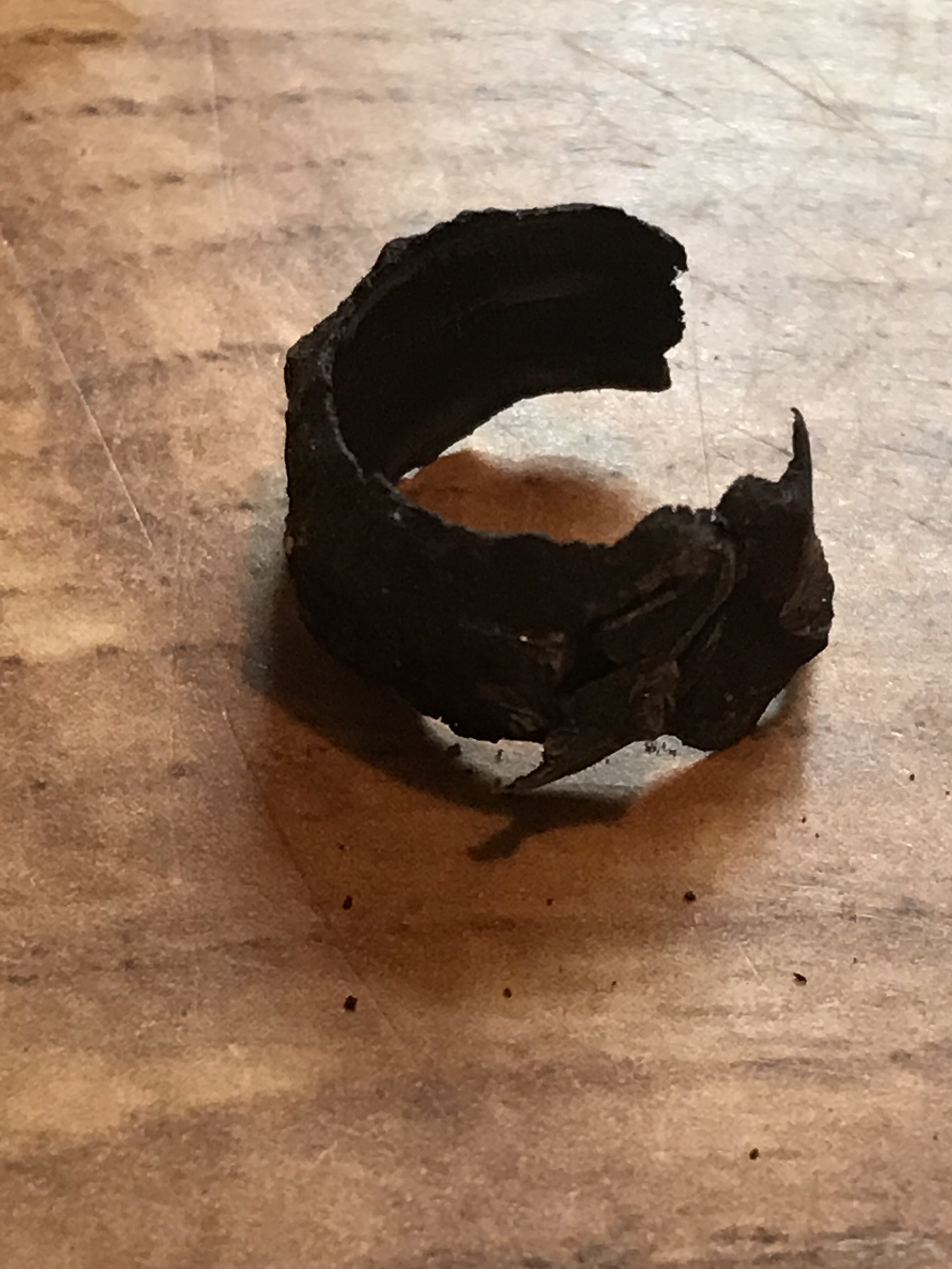

I dont think it broke the plug, just the ring. It just spun off the plug. Didnt even take much effort.
Who's responsible for this junk?
Okay Okay... Motorcraft or Autolite double platinums or Iridium's if you like spending money. Just don't get the copper ones...

Turdle is right, take it easy and it shouldn't be too big of a problem to remove them. That's a lot of corrosion, likely those are original plugs.
That's the negative of using the last forever plugs, the tips might, but leaving a plug in so long makes it way way harder to remove. I prefer to change plugs before 50k no matter what magic plugs they are. I'd rather spend $25 and 45 minutes of labor, once every few years, than to have to one time fight one plug.

went to put the new wire on and the ceramic on the plug is loose. so thats that.
Going in the shop Monday. Im not tackling that job at home...dont need to screw it up even more.
