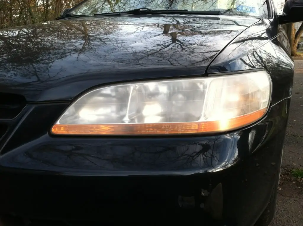

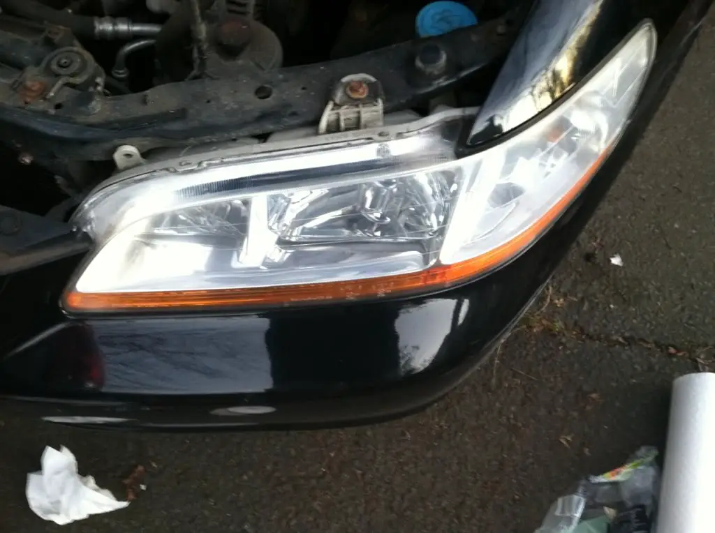

I have to add though, i bet if you can find the 3M restoration kit, it'll make the lights even clearer than u already made them, because I used the turtle wax one on my own headlights before the 3M one, and the 3M one made the lights even more clear which I why I went right to that one when I did my friend's mom's accord...here's some crappy pics of the job I did on hers, they were taken with my iPhone, the difference in person is like night and day
Before:
After:
After the holidays I will be looking for the 3m one but for now that was all I could find
cool....i got mine at autozone it was like 25 bucks and you do need a drill for it
Guess that means I need to buy a drill too
yeah you're definitely gonna need that for the 3M one lol a regular battery powered one is what I used
