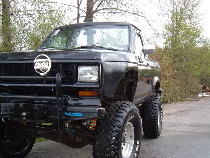

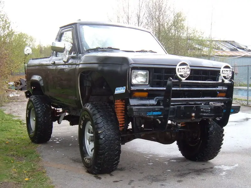

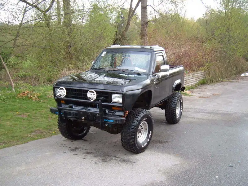

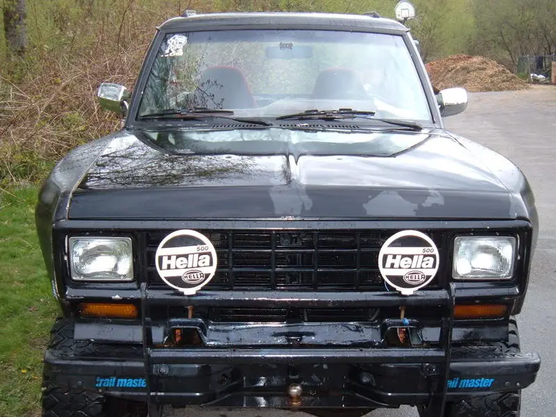

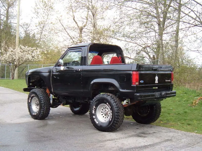

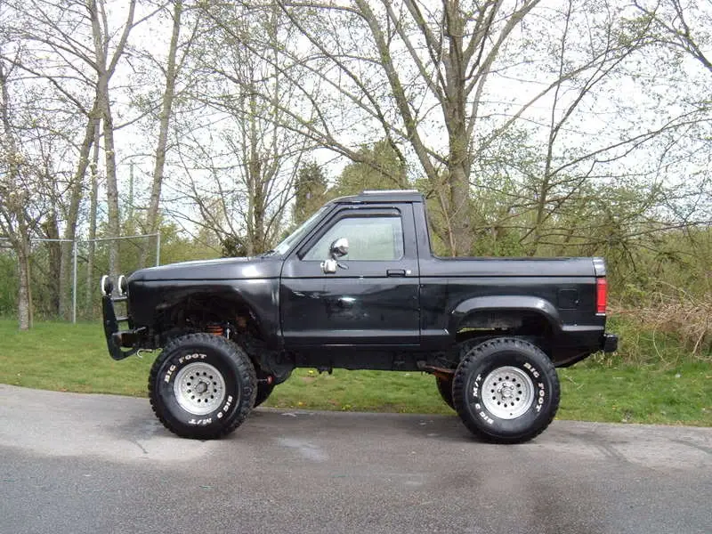

Alright got a lot of work done in the past few days, got the end pillers filled in. This is temp until I get a hold of a welder. I got insurance on it yesterday and took it out for the day, no wheeling tho, still need to get the front drive shaft shortened. What a huge difference with the top off. I can actually spin my tires now, but I haven't taken this out since the roof has been cut off, MDS Coil, glasspac, new plug wires and snorkel. Here are a few pics of where I am at now.
I just used the rear hatch door for my tale gate. Cut it off at the bottom of the window line. It stays in very well and does not shake around at all. used all the same mounting on the truck for the hatch, just turn the handle and you can take the tale gate right off.
love the rear wiper!!
Looks 100% better thus far
hows it running?
its running quite well, not having any problems other than a little oil leak some place, but it runs smooth, And it drives straight now! lol The Snorkel seems to be working okay, I was driving in the city for 2h's and was not over heating and ran smooth, and the hose did not get too hot where it runs into the cab. I think I will still rap it in some heat tape. I also got some new BDS shocks.

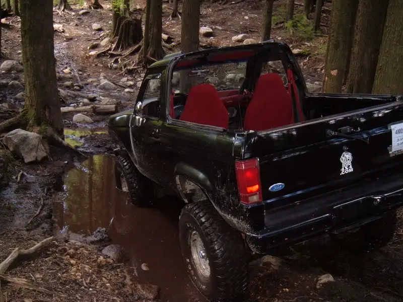

so I got to do some wheeling today. Been a long time, havent used the 8.8 or the D35 or the fiberglass fenders or the chop top yet... SO it was 100 times better wheeling than it was before with the 7.5 and D28. I could really notice the limited slip working..... So worked good in the woods... Not so good on the HWY

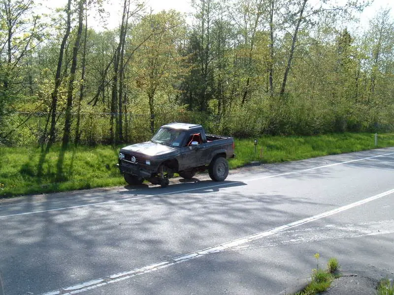

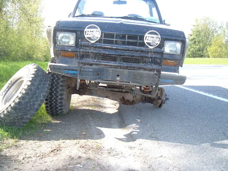

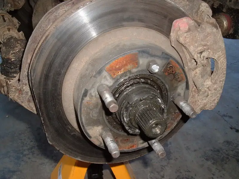

So here I am driving down the #1 hwy doing 100KM and I look over and see my tire infront of the car beside me... I think to myself... strange... That should be under my truck.... I tap the breaks and the front of the truck comes down on the hub.... start to swerve around, than I was thinking, "I think I should be flipping right now" but I kept is straight and got it over to the side of the road....
I am so happy that no one was hurt! This is a VERY busy highway!
The tire ended up about 1/2 km away in the ditch!
auto hubs? hehehe forget to tighten the lugs? one stud probably snapped when it came off and the rotor sure took a beating! Nidce glad it stayed upright and the tire didnt hit anything
yeah its auto hubs, but thats going to change now :) Not 100% sure why it came off. Had all the tires off 100 times in the last few months....
Here is a good question,
I still have my D28, can I use the old hubs from that on the D35? Like the disk part? Than buy a Manual Hub Conversion for the D35? Cause as you can see this one is not going to work. Also does anyone have the Timken Part # for the bearings? I can just grab them at work :) and the seal part # would be great. Are they National Seals?
Went wheeling today :) Got new warn hubs :) Very easy install :P All the tires stayed on this time
