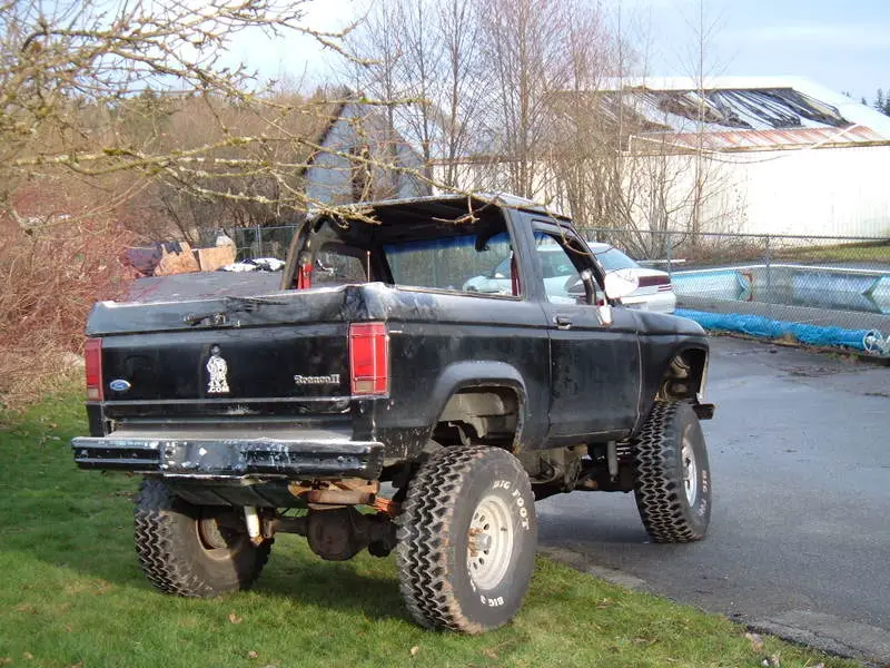

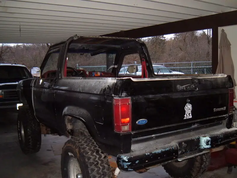

okay so this worked out real nice so far, first time I have used a angel grinder. I cut the brace on the sides and than just beat it with a hammer untill it bent up than just grinded away and it is closed up. Now I am not going to just leave it like that but its a start. Here it is, and a pic of the truck out of the car port
wow, that thing looks really light now. I bet i can take a **** heavier than your B2. However i think it looks cool. I like it.
Nice so far. I'd really like to see you invest in a mig welder and clean those cut areas up and weld some skin on them. That back part where you cut the roof off would be so simple. Just place some cardboard on top of the cut, trace and transfer that to some 16 or 18 gauge sheet metal. Cut out with some snips and then start spot welding in on top of cut. Then the top do the same. I may post some of my pics later or just go thru my build and you can see the areas where I did this.
Now with that said, the other way would be resin and fiberglass. It is very simple to work with. That back area near the tail light where you cut off roof support would have to be filled in with some kind of backing up to about a 1/4'" or so below your cut. Then buy some of the gorilla hair fiberglass that has all the coarse fiberglass strands in it. Or yo can buy just the resin and then buy the coarse fiberglass. Not the close woven matt stuff. Then you will pull apart the coarse fiberglass and mix with the resin. Kinda like what reinforcing steel bars does to concrete when poured over it. Mix in your hardener and then just slap it on. The coarse fiberglass will stick out of the mixture, but this will be grinded down within minutes. You will amaze yourself with what you did. Maybe you can wedge some sheet metal down into that hole to lay the fiberglass on. At the edges you can even get some fiberglass webbing and saturate with the resin and lay over the top and around the edges. Then just sand. The webbing is about 2 inches wide. Just lay part over the top where you have already applied the mixture and then overlap the sides. But remember it's no big deal if it's not right the first time. And believe me it won't. So just sand away and redo.
I did this method when I filled in the bottom rear bulhead behind the seats where it meets the floor. It really smoothed it out.
Keep it up.

Alright thats some good info to go with. I would love to get a mig but $$$ and a trip to mexico in the plans..... I will get one sooner than later, I am thinking in the summer time I will get one. But for now this fiberglass sounds real good. Now when you say "filled in with some kind of backing up to about a 1/4'"" do you mean like some foam of some sorts? The stuff you spray in from the can from a tube and it expands?

I'm no body man, but that's the idea. Just as long as the resin does not have some kind if interaction with the foam. Like it may eat it :eek: You can always try a test area and see if it works.
okay good stuff, I am going to be looking into that this week.
