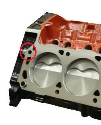

Here's a couple of pics showing the oil drain back hole. It looks like there should be enough meat on the head, and probably block to stop gravity fed oil.
Oil, definitely runs close to the end of the head sealing surface though.

Oil Returns
Those are great pictures of the oil return holes.
You can see that an oil leak there is possible, seems to be right where your leak is too.
Maybe something fell there when the gasket or head was going down.
