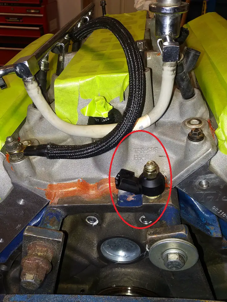

Look!
Its a knock sensor!!!!
Tim, recognize the heavy duty block to frame cable you made for me?

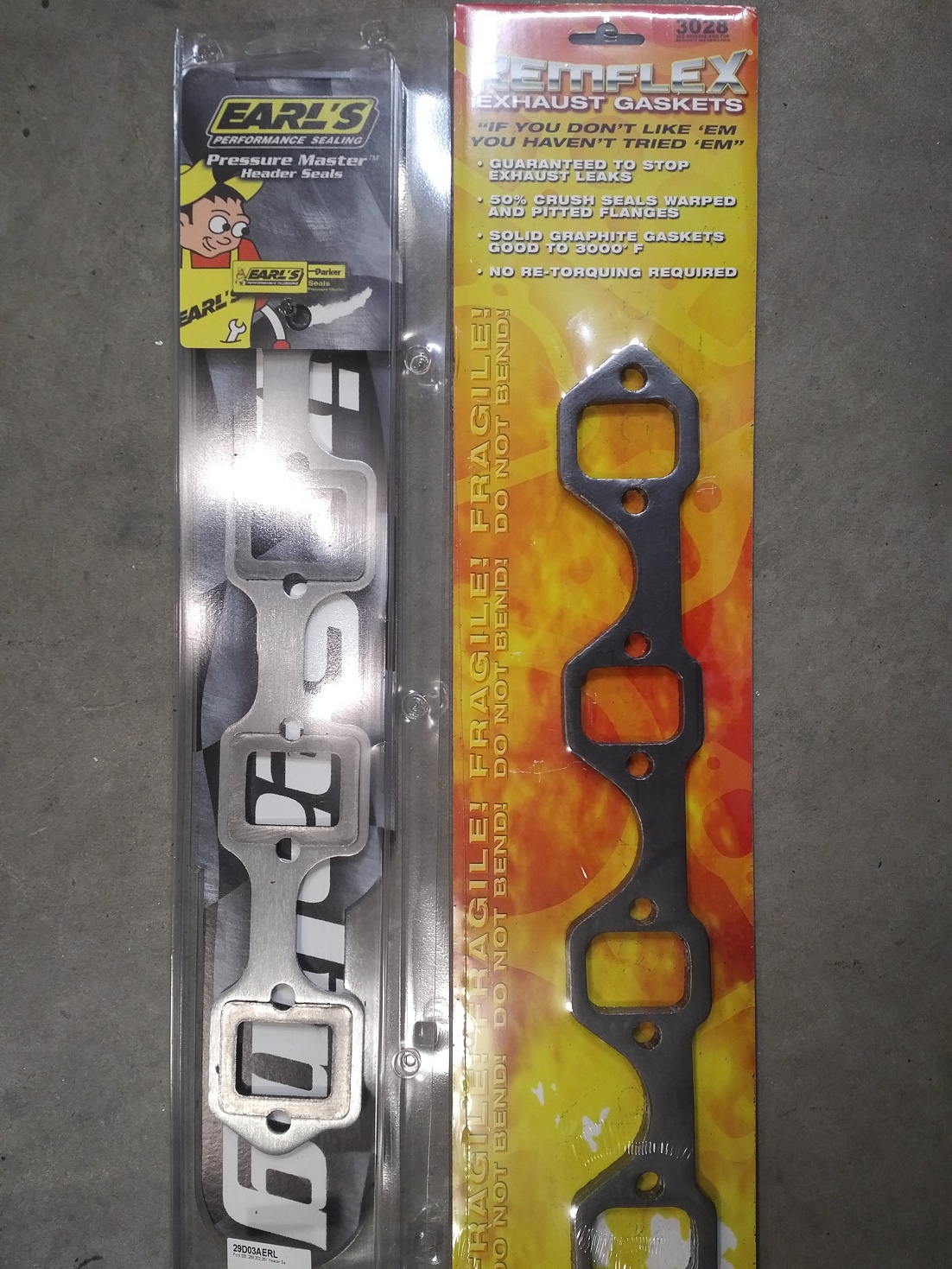

Then came a dilemma.
I'd read about another header gasket made by Earl's (929D03AERL(.
Same idea as the remflex 3028, but with a core around the outside that was not soft. I did have a remflex blow out on me (Remember, turbo back pressure in the exhaust) so do I try them?

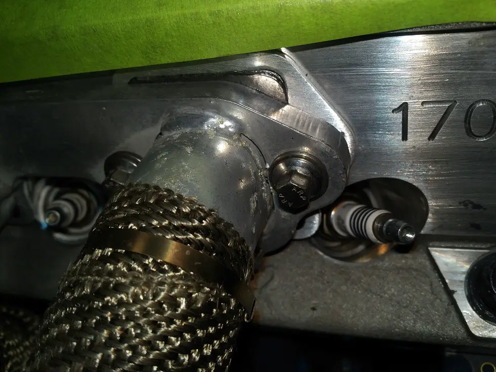

Here's what the crush looks like with the Earl's

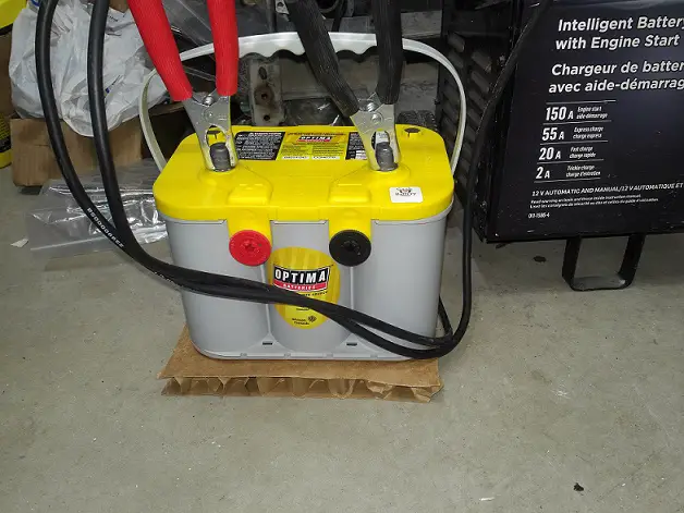

And, my 2 year old Costco battery died.
Most likely because I ignored it(and the truck) in the garage all winter.
Anyway, I tried multiple times charging it, within 2 days it would be below 70% capacity.
I remember 4pointslow saying that the AGM's do not corrode the battery terminals and how much he likes them.
Long story short, I found a way to order a battery out of province at a great deal and only pay one tax with free shipping. So, back went the battery for a full refund (I love Costco warranty). Thank you Costco.
So, for another $150.00 I now have a yellowtop. Thanks 4pointslow. lol
