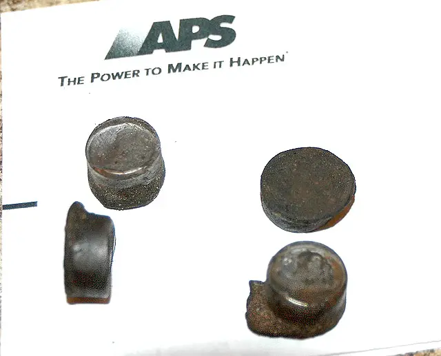

I had heard about people spinning their diff housings on the 8.8, but I never heard of any of our members ever doing it. That led me to believe the occurance was so rare that I didn't need to worry about it.
That was until the last time I went to Truck Haven:D I finally spun my own diff housing.
I brought it to FST to straighten back out and weld the tubes to the housing. When they started twisted the housing back in place the factory plug welds just fell right out.
Looking at them it's amazing they held for as long as they did. You can tell that there was very little penetration.

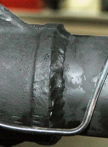

do you have the after pics of the beads they ran?
What type of welding will work on this diff and the tubes?
I've heard that the way to do this is to weld an inch or so on top, let it cool then do an inch on the bottom let it cool... and keep going like that.
Those are pins, not weld plugs.
Well the welded in pins fell out:p:
Or you can just weld 3 or 4 half or one inch spots equally around the tube housing. I even had my axel truss welded into where the tube meets the housing
It's a good idea to have the housing checked for straightness afterwards. For sure if it's welded all the way around.

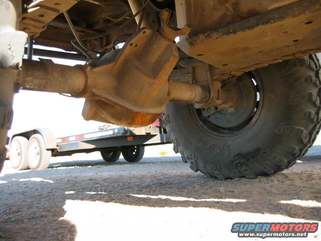

well with a pinion angle like that what do you expect. :rolleyes:

yea that pic is with the diff twisted
