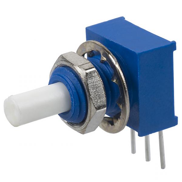

There is a huge electronics store in Westland, MI about 15-20 min from my house and near my engine builder. It make's radio shack look like a the cart stores you see in the mall. I need to go see my builder anyway about the 347 block work. I can stop by the electronic store and pick one up. Can you give me some info on what to ask the clerk so I don't get a blank stare. :) I'm not versed in electronic components.

It needs to be vertical, leads on bottom, with shaft going out front ( to reach outside the case. I would be grateful.

located this, 127 in stock-think I'll buy a few at $2.50 per ha ha

I replaced the trimmer pot, which I recieved thanks to the great customer service at www.digikey.com
A big whopping $2.56 part was the fix!!!
