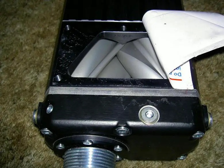

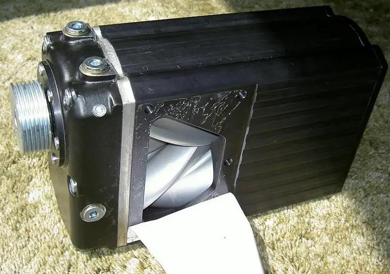

Funny, I'm still on the fence about a supercharger or a turbo. Finding space to run two pipes rearward for a turbo is the big drawback. That intercooler size I posted pics of might make space for my KB 2200.

I found this KB two years ago from someone giving up on big block Chrsyler build. It's new but has no snout extension. There's a friend(Todd, last page) who has a Ranger with a 302 and a 1.5 KB on it. He and I were both trying to work out how to get an intercooler between the KB and intake. He kept going with the Mustang layout(KB on its back), and I gave up on trying to center it, then decided that there wasn't enough space under the hood. Now I'm rethinking it slightly, I'll see if there is enough room for the two turbo pipes first.
I'd like to orient it just like it sets below, mount it to the passenger side of the intake above an intercooler.

Interesting. I would not be up to major fabrication and would go with the KB GT40 style intake. I have seen Todd's Ranger in some posts. Very nice.
