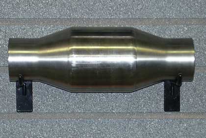

I was thinking if I got rid of my secondary cats I could fit a muffler or two there. Currently running these.

That cat is what I have to go into mine, hopefully they work well. You have tons of space under the truck to add two large mufflers if you'd like. They can go side by side, tilted a about a 45* angle, in the stock location. You can keep the spare and have twin pipes, but the obstacles on the left have to be moved some.
