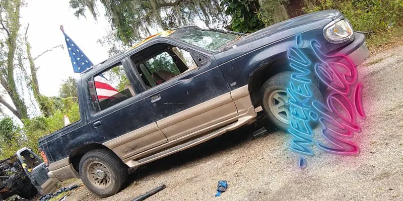

I lost the key to my Merc and wanna know if I can carb swap it and run the truck it's only a woods/farm truck already have all the ignition switches wired to a switch and the truck will crank but no start, if I spray starting fluid in the intake it will fire but no start because of pats. Love this forum, it has helped me out so much.
Carbed would be tough because you have to add a distributor to your 302 and the PCM controls your auto trans, so if you get rid of the pcm your trans will not shift properly at all

What year is that chopped up merc? I know its 98-01, looks like an early 98 to me from that pic
Thanks for the reply, it's a 2000 and 2wd with many options, still have the original window sticker, could I just get a pre pats pcm I've already bypassed the lock cylinder so I have steering access to all my gears and it will crank
