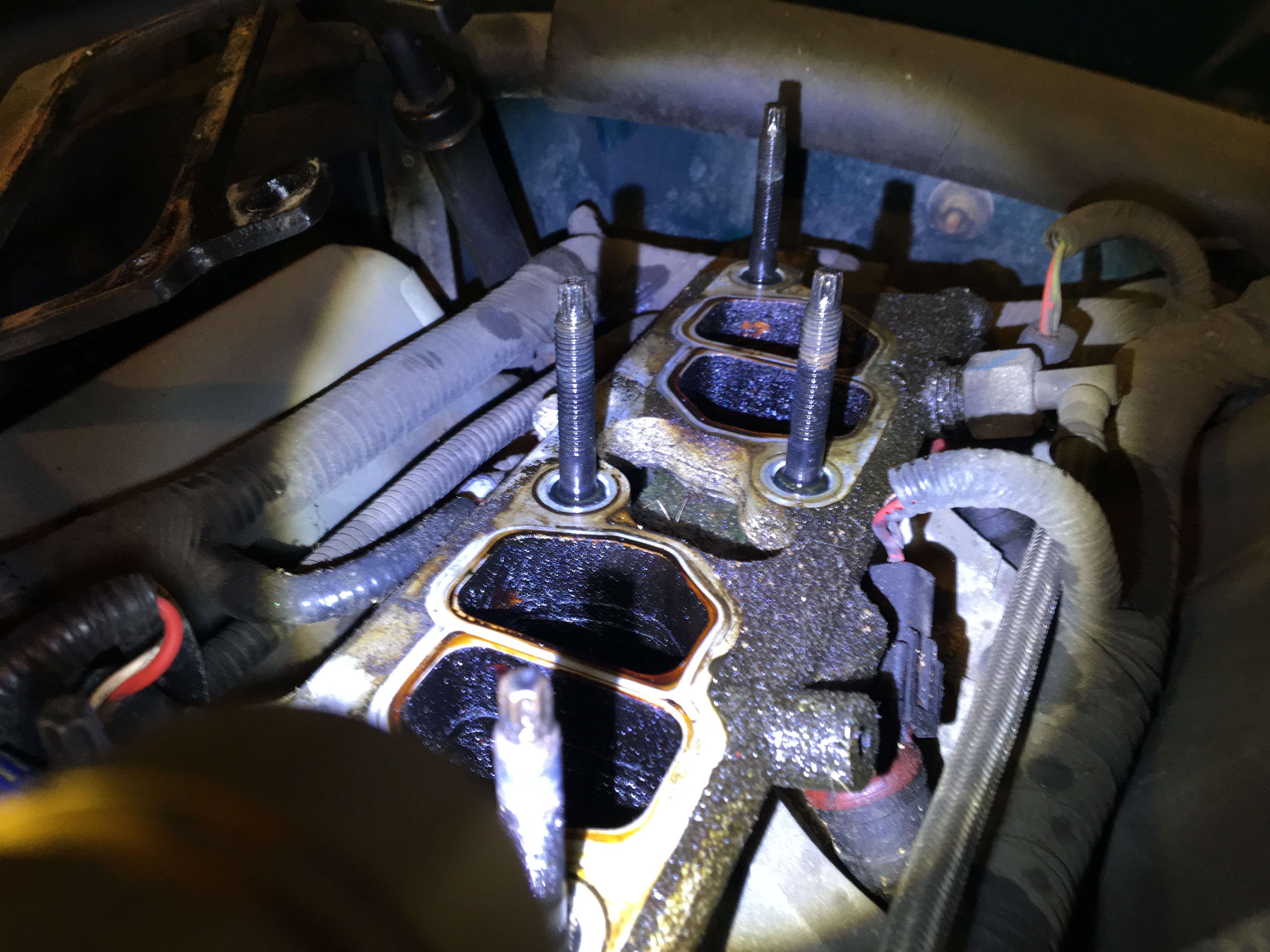

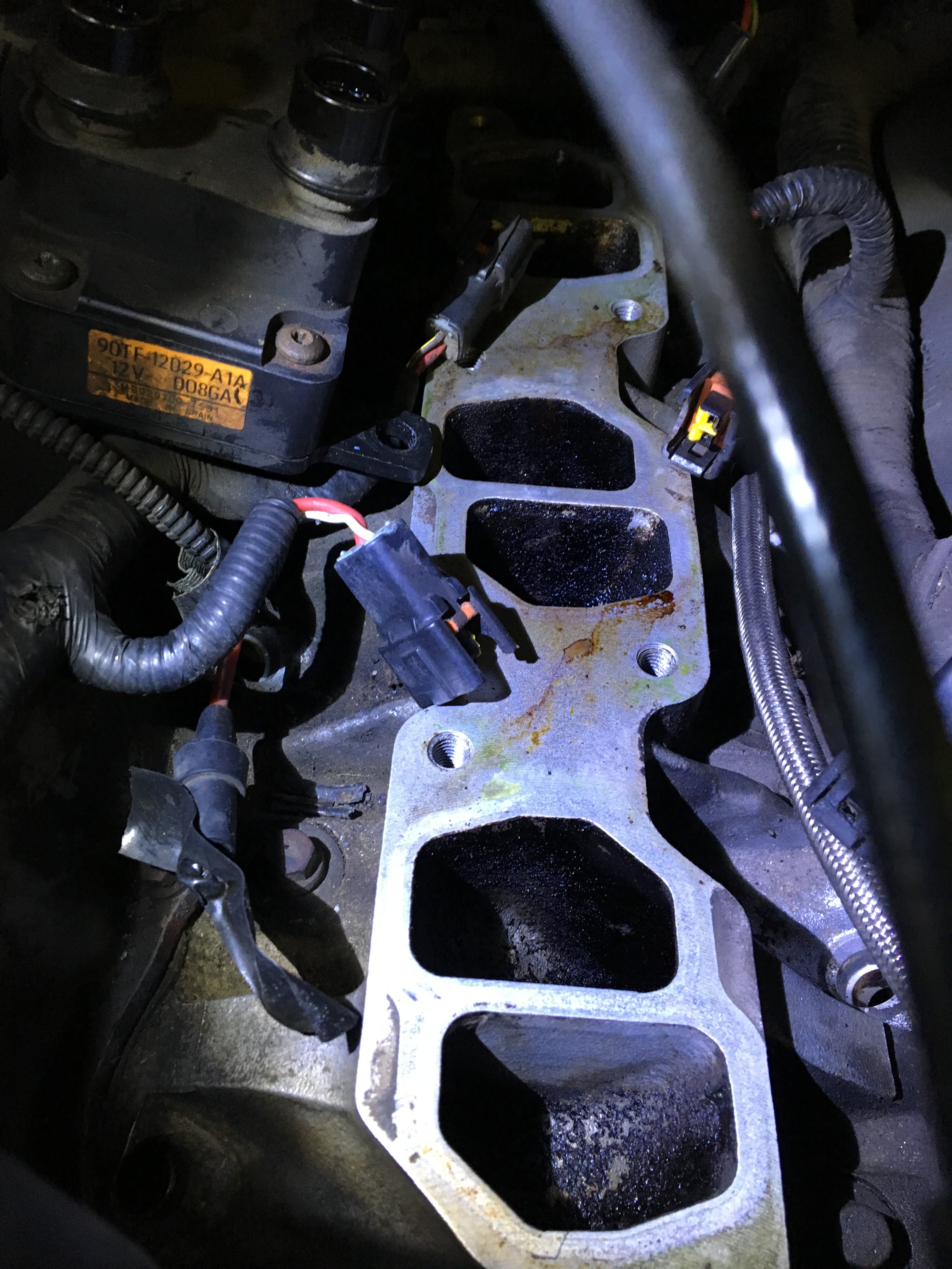

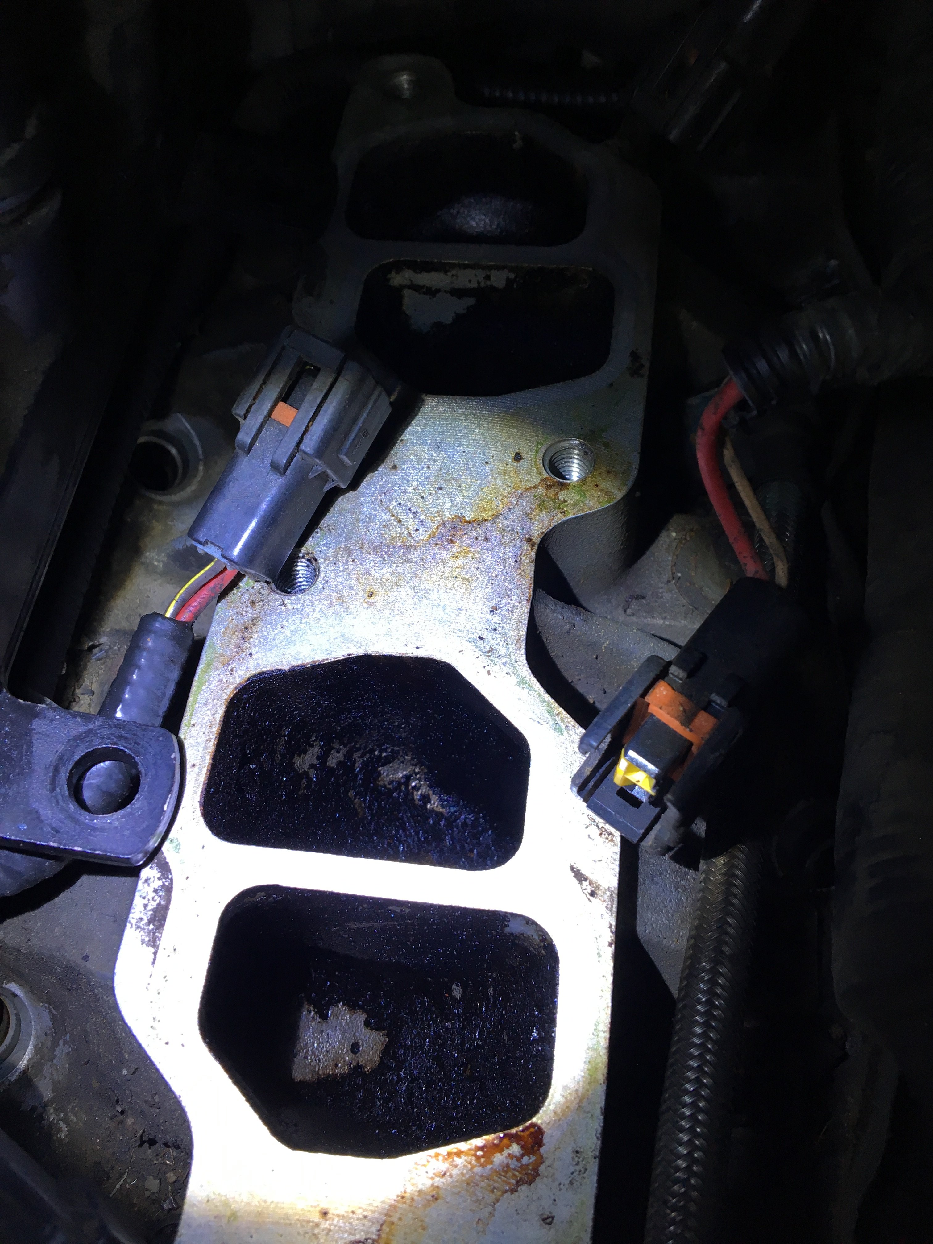

Replaced ect previously. Update got rail and intake off. Pulled injectors. Getting cleaned and rebuilt. All ohmed around 16 . Anything else i should do with it this apart? No rush shes sitting in the garage. Inside of all intake channels nasty and black buildup. Any suggestions welcome.

Maybe lower intake manifold gaskets if you are that far in? They do fail eventually.
Could be carbon buildup on the valve from short trips. That can cause crappy running.

Alot of carbon buildup visible through empty injector holes in motor. Def encroaching from the sides creeping over. How do i clean intake valves if neccesary? Will try and scope them to look. Was bank 1 sensor 1. Dont remember code. Replaced sensor and it went away.
Heavy deposits in the intake and on the valves would make it run bad or at least less that optimal, but I don't see how that could cause it to not start sometimes and start just fine other times.

At this point clean it up as best you can and see what it does after you put it back together.

They could act like sponges at certain temps, drinking up the gas. If his grandma used it for a 2 mile drive to church or shopping, that could certainly cause it. There are products made to clean GDI engines which have this problem, can also be used for regular engines too.
Some white deposit on old 02. Injectors are nasty looking with black buildup all over pindle caps. Bottom of o ring i can see was allowing engine dirt to get sucked in on several injectors. Waiting on gasket to reassemble.
yea i will, need to upgrade to post pics i believe. i got borescope down in intake below fuel rail. all the black and brown gunk on sidewalls stops and disappears before the valve. i guess its backside of the valve but it looks clean as far as i can tell with my crappy chinese cell phone scope lol. was reading about injector heat soak with short drive cycles. trying to clean oem injectors. energizing in pulses with cleaner. one def was plugged. also read if one is plugged engine reads lean and trys to overcompensate with other working injectors?
