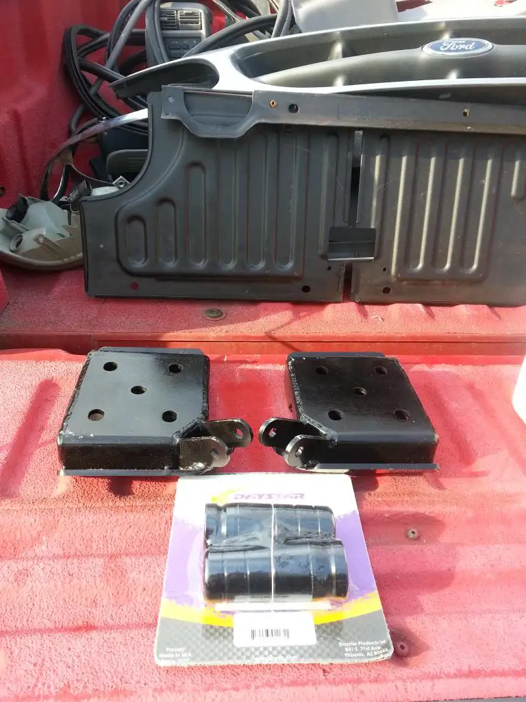

Cool new parts today! U-Bolt skids are courtesy of our very own Brian1. These things are beefy. And the bumpstops are for the front to be used with the superlift and coilover.
Which may not be happening for a while. Thanks to Superlift continuing to push back and "wait for parts" that has been on order since December 15th, it looks like I'm going to be just going ahead and getting the body put back on. Once it finally arrives, I can probably just take a weekend and do the lift and conversion. So, for a little while it'll be back to the mostly stock suspension.

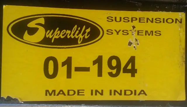

It's heeeeeeeeeeeeeeeeeeeeeeeeeeeeeeeeeeeeeeeeeeeere!
It's here! Yes! Finally!
And the one thing I don't like:
Leaf springs are made in india. Those will be replaced eventually by a set of 4" lift SUA Deaver springs, probably after I do the gears, locker, and axle shafts.
As for the kit itself, everything seems solid. Nice thick steel, good paint (powdercoat, I think) and detailed instructions. I was surprised to see the knuckles were painted, as I thought they were left as-cast. That saves me some time painting them myself. I'll be studying those instructions closely the next few days. Full inventory will be done Friday, since I don't have much time til then. Seems like everything is there though.

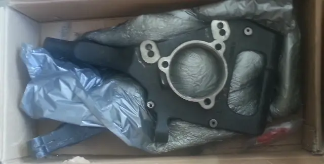

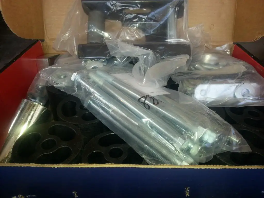

More new parts! Got my 883 :usa: made body lift kit in today, as well as the replacement shackles. Though, I'm wondering if I'm better off just using the beefier (albeit liftier) Warrior shackles as opposed to the chinese ones... Just don't trust them to stand up to lots of wear and tear. Even the OEM ford ones aren't that great, as I pretty much tore them in half with my hands to get them off.
Bad news though. So if anyone is wanting the following Daystar poly bushings, lots are no longer being produced. I found out today from 4 Wheel Parts (5 days after I placed my order, gee thanks)
Poly Bushings List as of 05 April 2013 - Subject to change and I might not be 100% right:

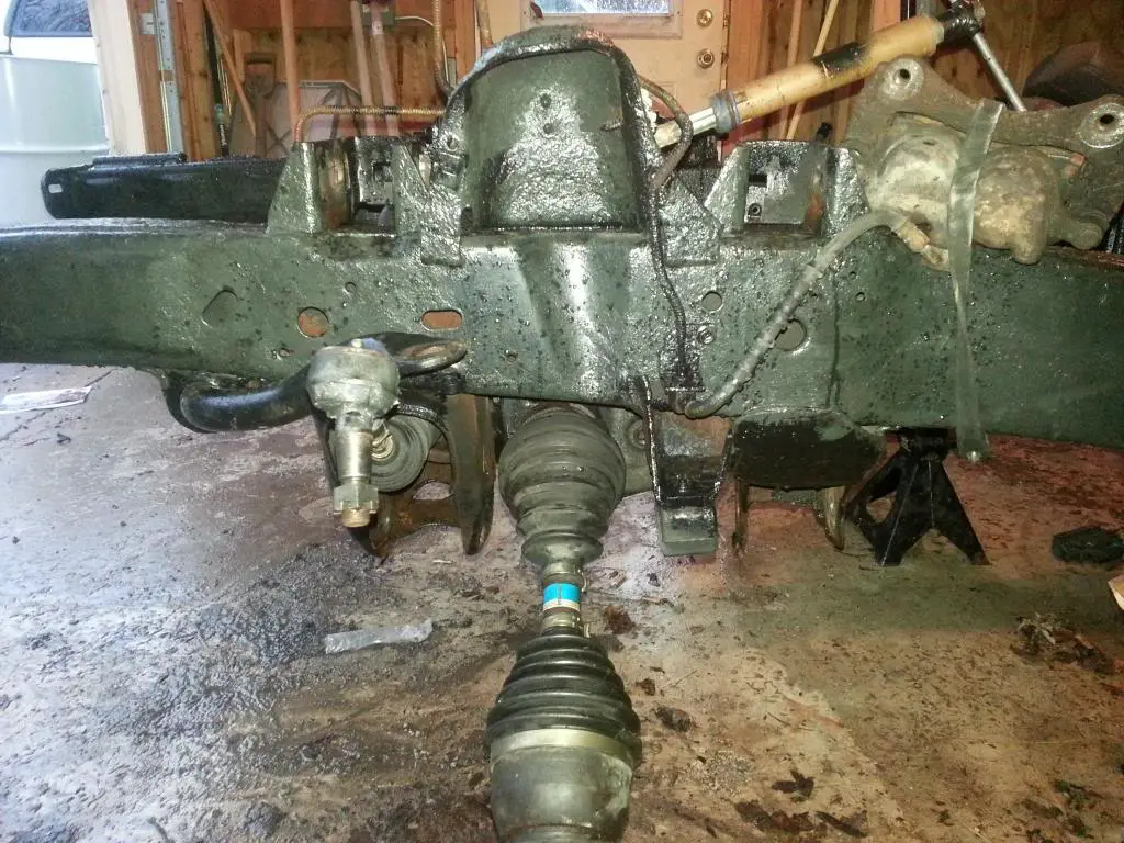

The Superlift leaf springs and ubolt/shock skidplates are installed!
I posted more over in my resto thread, but figured I'd update here too. Nothing's torqued yet until all the weight is back on, and the ubolts are only there til my 5/8" ones come in, but other than that the rear is done. Removing those shackle bushings was soooooooo much easier than I had feared. A buddy of mine gave me a tip on using a drill bit to drill into the rubber, and it will catch it and start spinning it out. Took literally one minute combined to pull both sides, and I was ready to fight them for hours with sharp objects and flame. Kinda sad I didn't get to use the flame, but oh well.
I'll start the front tomorrow if it doesn't rain so I can flip the chassis around. I don't want it getting wet because I'm gonna put a few coats of rattle can medium tan on the axles, springs, and shackles. Nothing super tough, but it'll make it look cooler for a while.

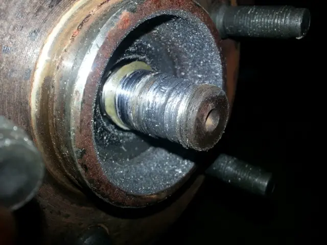

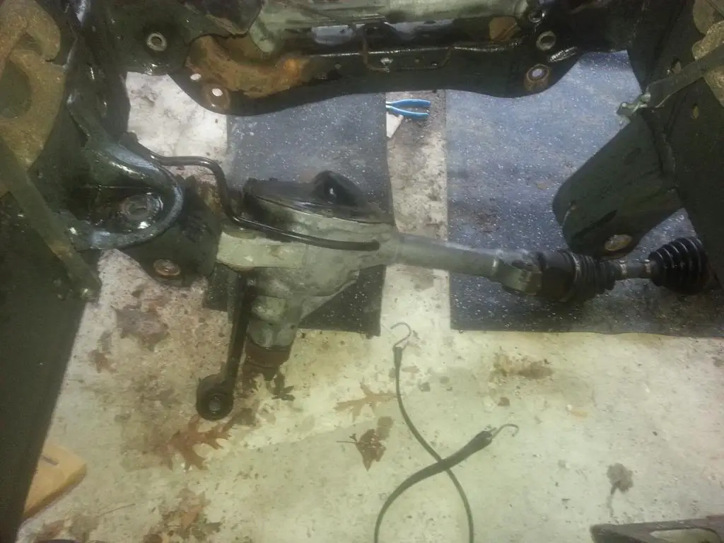

Good and bad news today. Bad first. I need new CV axles:
Good news is that the floods that shut down Chicago area didn't hit hard here. Even my garage wasn't flooded, which really shocked me. Wet, but not flooded. So I was able to get some work done on the front end.
After spending about half an hour swearing and huffing to move the chassis around by myself, uphill and slipping in mud, I got it in. Took off the sway bar links, unloaded the torsion bars, and proceeded to tear apart the driver's side.
I still need to somehow get the torsion bars out of the LCAs. Time, rust, and POR15 have effectively fused them into the hex slots. I think I might need to rig it up somehow on a hydraulic press to get them out. I also need to press out the old bushings, salvage the sleeves, and get the new ones in. Ball joints and tie rod ends are still in great shape though, less than ten thousand miles on those. And all high quality Napa and Moog parts. I also have to get the Dixon Bros clevis inner tie rod installed and rig the boot back up to cover it.
I'm gonna order some new (not reman'd) Cardone CVs tomorrow once I get paid. Pretty sure these are the same ones Napa sells. Wish I could get the 4340 RCV Performance custom CVS, but I don't have $2500 or so laying around doing nothing. Or I could replace the CVs twenty times and still be ahead, so those might never happen. So for now, I'm just gonna get the passengers side apart and then wait for the weather to get better to put some more POR15 on the spots I now have access to, paint up some of the components and brackets, and press the bushings in before I start reassembling and modifying. I may go ahead and put another coat of POR on the frame too, since I have unlimited access and there's a few spots where the paint flaked from being hit with wrenches and ratchets and punches and chisels.

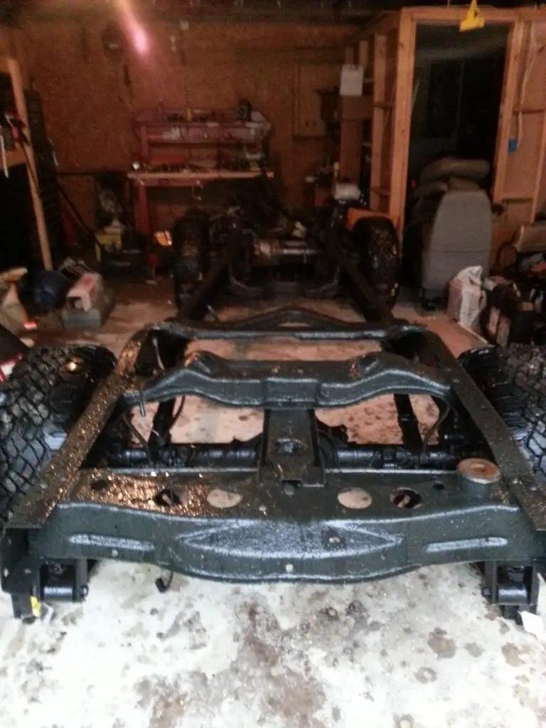

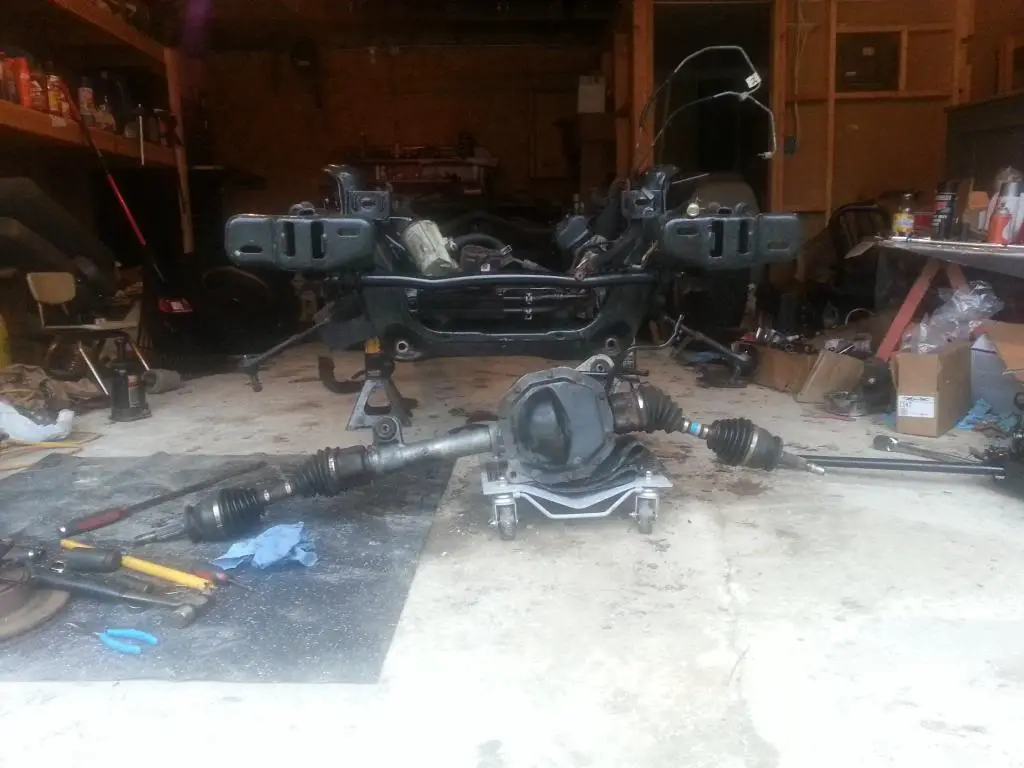

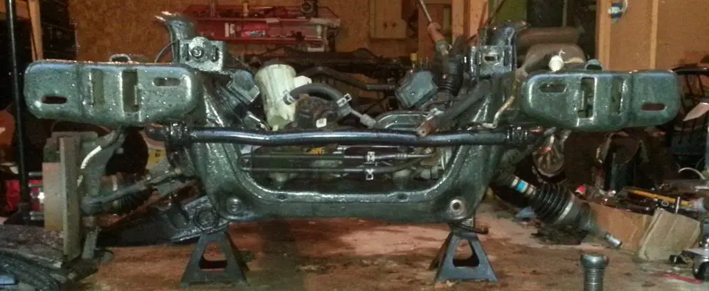

Latest progress:
All the front suspension is disassembled, and the front axle is on the ground. Everything went smooth as silk until i started lowering the axle.
Oops! :bsnicker:
Couldn't find my other set of jack stands and I decided to just go ahead and lower it anyways. Well, once the jack got close to the ground it rolled off and fell on the pinion shaft. Nothing was broken, and I'm regearing it to 4.56 with a master rebuild kit anyways, so any shock load on the bearings isn't a problem. I'll double check the inside of the pumpkin for any cracks or anything, but since it only fell about five inches I don't think any real damage occurred.
Once the weather clears up (66 yesterday, today it's snowing, what the heck?) I can start the painting. The control arms, some of the brackets, the dust shields, basically the small stuff, I can take to work and use our paint booth there. The frame is gonna be waiting for a few days, if not a week or more, it seems. In the meantime, I can cut and drill what I need to for the coilover conversion, and I might take the steering rack out. My left inner tie rod feels really sticky, and it's also good practice for when I'll need to do it in the future. Also gives me access to paint underneath it. And makes it easier to swap in the new HD inner tie rods.
I also need to finish ordering replacement hardware. The Superlift kit only comes with some of what I need, and I'm not going to use what they supply anyways. I don't like mixing SAE and metric throughout my entire vehicle. It's a bit expensive, but ordering all class 10.9 metric hardware, with high quality plating, means it's a lot less for me to worry about in the future.
I'm also wondering if I should bother replacing the bushings in my control arms right now. The uppers are only about a year old and nice Moog ones, and the lowers are still in fantastic shape for being stock. I don't really need polys that bad to go through all that hassle. And if they fail ten years from now, I have them already. Keeps me on the safe side if they ever get discontinued too. Just have to make sure I don't lose them, haha.
