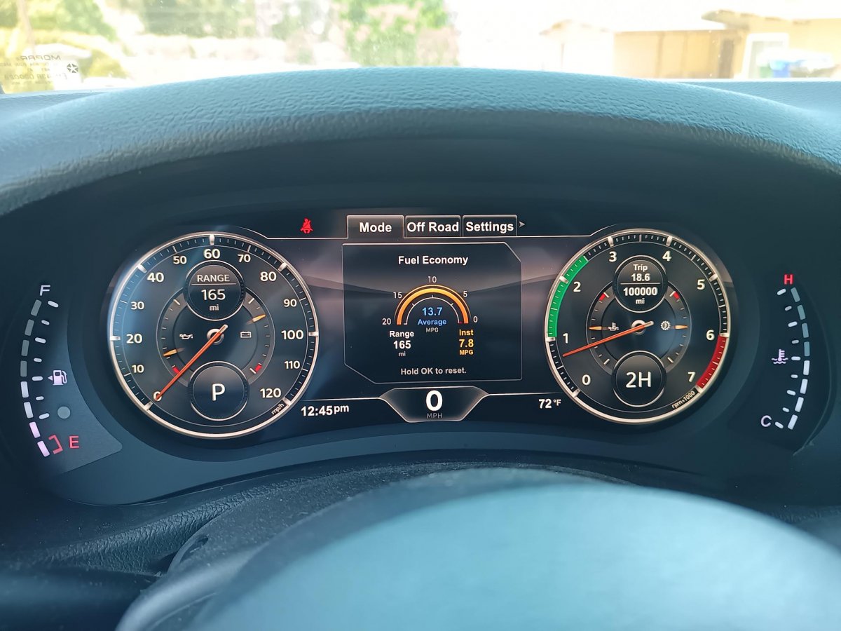

Hit 100k miles today.
My Ram is averaging about the same mileage. It's' a 2003 and it just hit 200,000. The 7000lb Ram gets better mileage though. ;)
