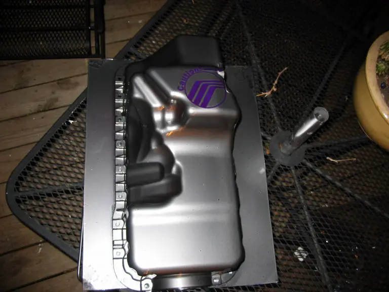

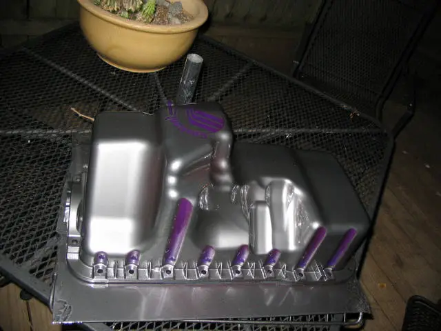

I have the pan washed and it is out gassing now-which means I am baking all the oils from it I can prior to blasting-
