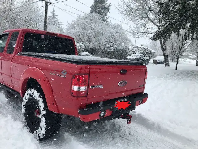

About 10" in Tacoma so checked out the Ranger's snow prowess on some unplowed streets. Just 4x4 High with the FX4 LS and Cepek Fun Country tires - - also has a pair of 80lb. dumbbells in the bed with recovery gear. Performed like a champion.

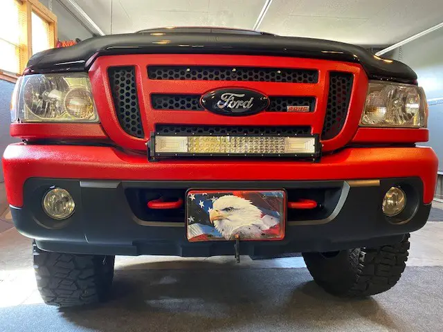

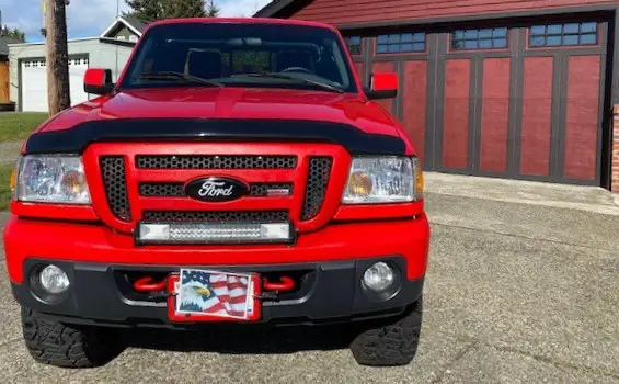

Had a buddy figure out a way to turn off the Daytime Running Lights in the Ranger. . . Minor modification, but as "Control Enthusiast", I'll be the decider when the damn lights come on, no offense to our neighbors to the North.
You'll have to trust me that the engine is on . . .
Paul

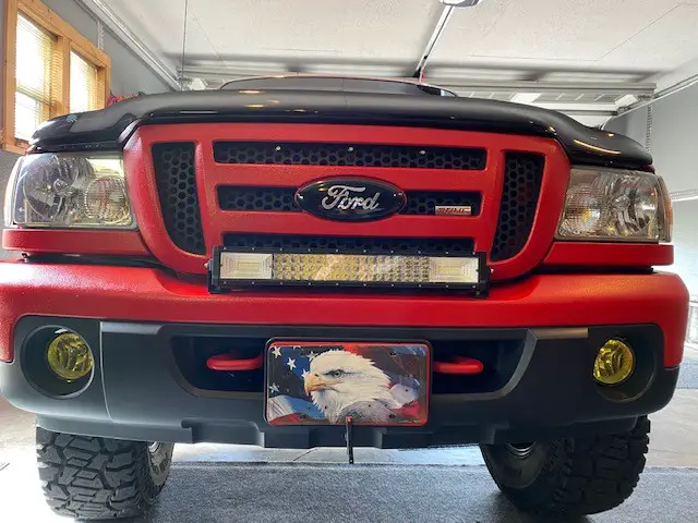

Minor stuff, but fun to play around with. . .
OEM Fogs:
New "Euro" style:
(Yellow lenses, hint hint)

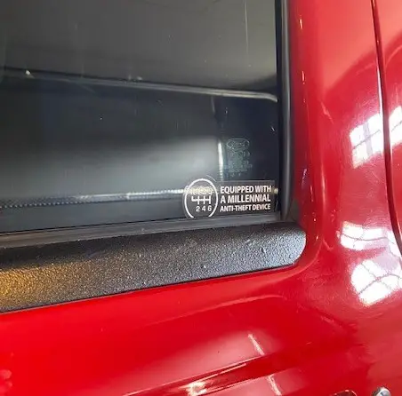

Also installed a new anti-theft device. . .
Well, the sticker ought to deter a few would-be mopes . . .)
Paul

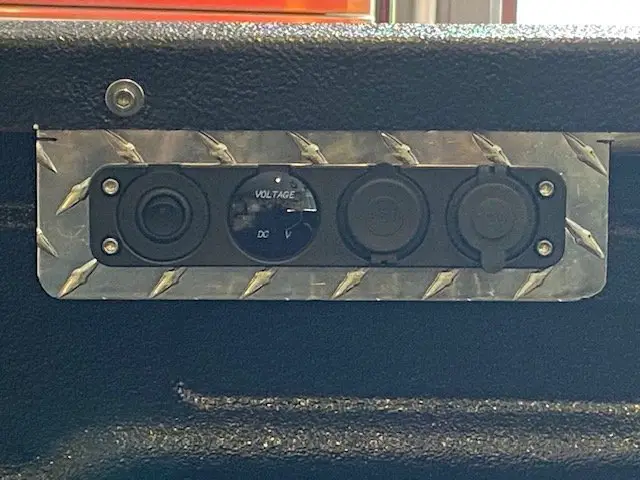

Like the idea of a few under bed-rail LED lights to illuminate the cargo area - - and have a tonneau cover on the bed most of the time. Also wanted the option of plugging in my ARB 37L fridge for trips in the Ranger, so a 12V outlet and adding some USB ports made sense. As the fridge would need to run without a keyed ignition, needed a "switched" power port.
Here's the unit:
One of the four under-rail LEDs is forward of the unit, facing down. Power unit is on the driver side about a foot from the tailgate.
Biggest pain was routing the wiring, as usual. . . Had already run wire loom flexible conduit from the front of the engine bay down to the rear bumper for the LED back-up lights, so it was just forcing the wire into the conduit - - just because I can't help it. . .
Wiring:

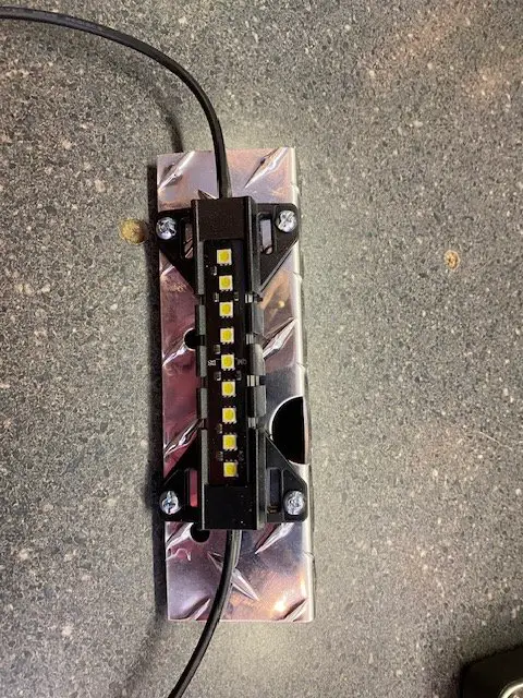

Less effort today, but mounted all the lights and did a test fire. . .
Reviewing the thread and noted that I referenced these LEDs in a 2021 post, so obviously, I've been pacing myself. . . Diamond "L" bracket just some leftover scrap I had from when I built my camp trailer.
Two per side:

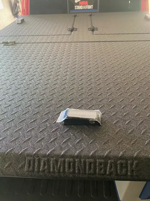

In my defense, had hesitated on the installation of the bed lights I had since 2021 because I wanted to make sure there weren't going to be any clearance issues with this:
At least that's my story and I'm sticking to it. . . Didn't want to mount the lights or power strip in a place that would interfere with the eventual installation of the improved cover. It's a Diamondback 270, not mounted yet as I have a load to haul in the bed in the next week or so. But it clears the top of the ARB 37L, which was pretty important.
Mounting and removing not difficult, but a bit more time-intensive that the current simple tri-fold tonneau cover.

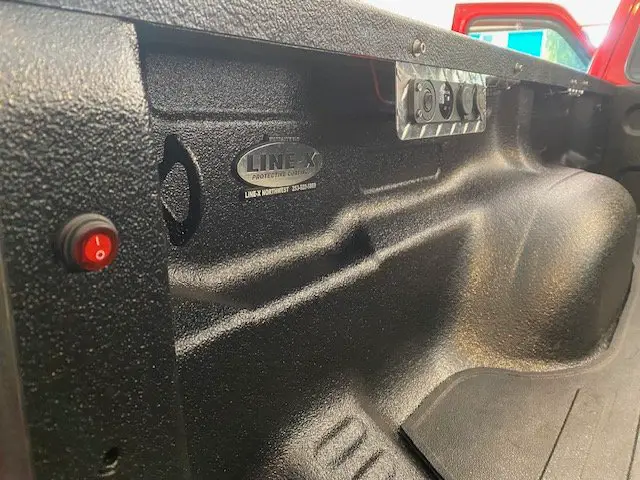

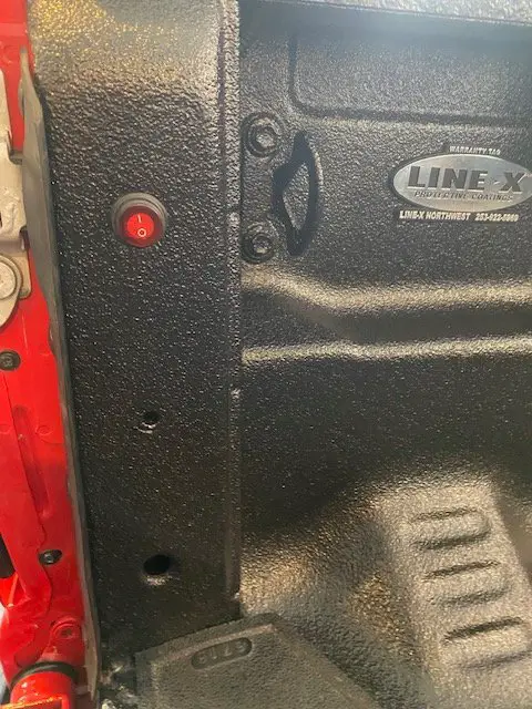

Semi-flummoxed over the switch location for the bed LED lights - - didn't make sense to have to turn the key "on" just to activate some low amperage LEDs (as the visor shelf switch panel is tied to the ignition), so inside the bed it goes. . .
Where? Due to the short run of wire between the LEDs, I had to place the switch to the 12V plugs and USB ports inboard a bit deeper than I preferred. When I built the switch plate that holds one of the LEDs, didn't think about adding a bed switch for the LEDs, and didn't want to add it after the fact . . .
So, it ended up here:
Works for me.
Will mount the new DiamondBack cover in the next few weeks.
