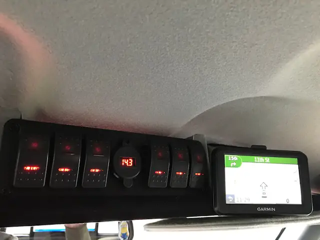

Switch upgrade . . .
Haven't finished the job yet, but knew I'd eventually upgrade the switches - - the "temporary" location wasn't really getting it done. Glad I didn't cut up the dash, but the switches are a bit out of reach. . . and I know I'll add more electronics. So the solution was to mount the switches overhead, like I had in the Sport. Actually "harvested" the shelf from the Sport in order to mount the new switch panel.
So here's what I'm going with - - gang of six with built in voltmeter and two USB ports.
The panel is set up for flush mount, but since it'll sit on a shelf, I need to fabricate a 'box' for it. Photo above is some rough fitting.
Happened to have some vinyl on hand that was gray enough to match the interior, and started "crafting". . .
Here's what it should like once all mounted up, but still a work in progress:

Here's the final product . . . now just need to wire up some more accessories. . .

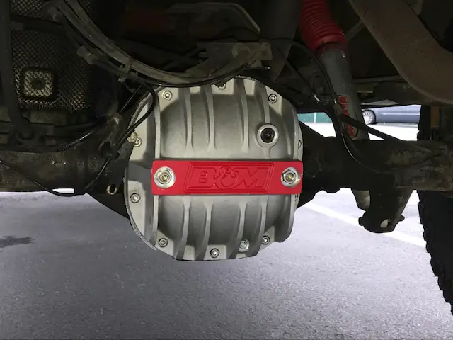

Not all lights and decorative badging. . .
Work weekend up at Kevin (Diff Whack)'s melding two great Explorers into one, and got a little bit or work done on the Ranger. Was seeping gear oil from the rear diff pinion seal so swapped that out and replaced the axle seals. . . Was "hoping" that the last year Ranger FX4 had the 8.8 with the 31 spline axles, but not to be - - just 28 splines (guess it was only the first FX4 (2002[?]) and the "Level II"s that had the 31 splines...
Did have to dress it up a bit, since we're down there getting stuff done. . .
B&M 40297. Went from five pints (80 ounces) of gear fluid per Owner's Manual to five quarts! That ought to keep it nice and cool back there. . .

That is alot more oil. I would keep an eye on overfilling it (higher that factory level). That can cause a pinion seal or wheel seal to leak. Ask me how I know...

I agree do NOT fill that rear end up to that fill hole you will flood the tubes and oil will push out the vent line, axle seals and pinion seal
Instead use that hole to fill but put in the recommended amount of gear lube (or fill it up to the factory fill plug)
The 8.8 in my BII has been turned up quite a bit, the pinion is turned up about 4-5 degrees from a normal 8.8 in an Explorer due to my short wheelbase. Because of this I cannot fill the rear axle all the way up to the fill hole or it floods the tubes and spits out gear lube from the breather. Took a while to figure this out....now I just fill it up with 1/2 quart less then recommended. It has been this way for 15+ years, these rear axles are strong

Thanks for input / advice. . . This cover is big, even larger than Mag Hy-Tec on the Sport. . . Fluid level is an inch below the fill hole, but now share your concern with stressing the seals so will probably drain out a bit. Guess it was smart to swap axles seals at the time . . .

1" below might be the correct level? Just pull the factory fill plug and let it drain till it stops :)

agree thats what I would do

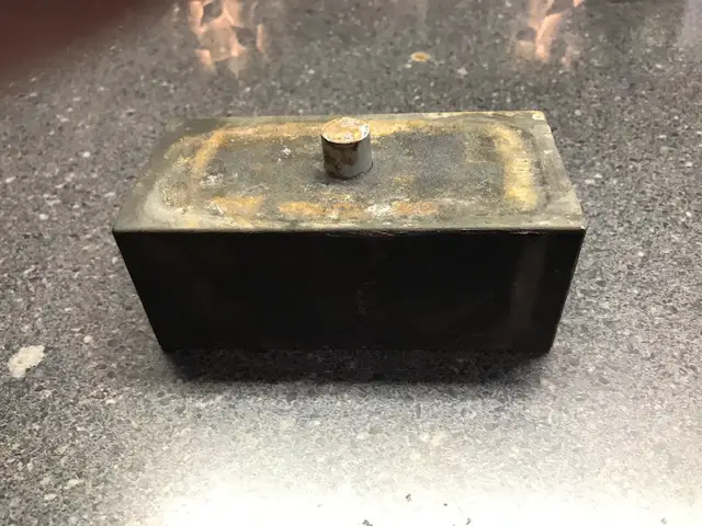

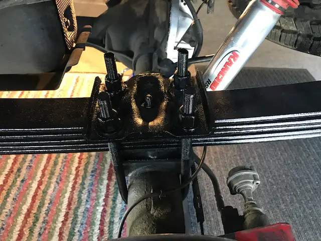

Back at Kevin's shop to swap out the blocks that came with the new torsion keys with a few more leaf springs. Had to crank the torsion bars a bit higher for better clearance for the larger tires, and would prefer more leafs to blocks.
Got rid of these:
For these:
These springs were out of Phil's (Albino94ltd) Explorer, Kevin bought it for the body and I'm taking some of the parts for the Ranger and a 'Sport to be assembled later.
Good ride height and rake (about 3/4" higher in bed), and with 180 lbs. on the trailer hitch only 1/2" compression. Can also put the OEM overload spring in the pack if I get any droop over time. . .
