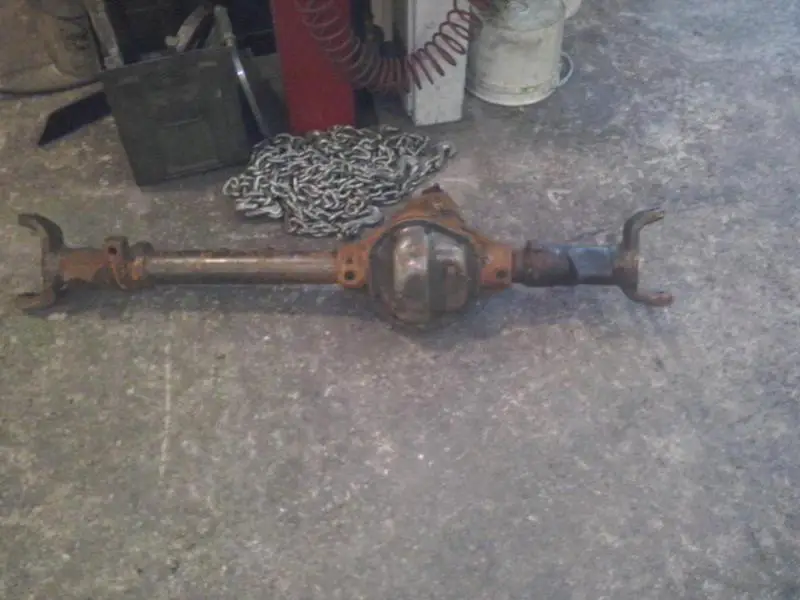

So, Last night, I dropped of my FW D44 at the local mad scientists shop to have 6" removed... probably the one n only time I'll ask someone to take 6" off my shaft... badum tish...
And just to confirm that this is the correct shaft I need before I go and order it

Making progress. Sorry I can't help confirm if you have the right axle shaft..

Bkennedy just went through this. You might want to check his thread or ask him...
