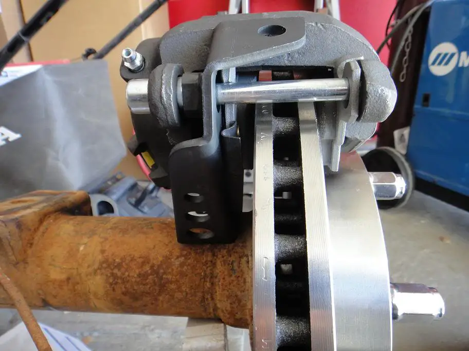

So I FINALLY found rotors that will work in all dimension. I went through 7 different sets and ended up with rotors off of a Dodge Dakota. So here are some images of my home made disc brake conversion for my 9", sorry for the mess in the background...too many things going all at once:

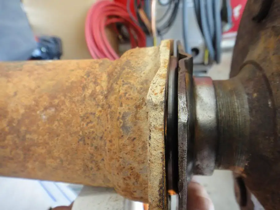

Now I need some help from the Ford 9" guru's. Look at the images below and remeber that this axle had drum brakes. When I bought the new axle bearings and had them pressed on, the axle does not seem to full seat. Note: There is NOT a 3rd member installed in these images. I spoke with a local shop and showed him the issue and he stated to just add washers between the flange and backing plate. Does this seem correct? I have looked at every bearing option possible for this axle....I think. Worst case, I was going to fab a plate that would fit in this location and give me a "better seal". Any thouhgts would be great.
I am also going to heavily tack my spring perches on today. Would it be wise the add 2 degrees of pinion angle, or should I stay with the stock angle? I know that this could help with wear on U-joints, driveling vibration, and also help to protect that carrier a bit more. Open for suggestions.....
I was told that this is normal and I am going to fab a 1/8" plate to sit in this location for cleanliness and bearing protection. I got the axle polished and ready for paint....waiting on my 3rd member to get done. I am going to do the 3rd member in gray and the housing in black (POR 15). The guy is taking forever setting the gears and such, but it's free so I'll live.
