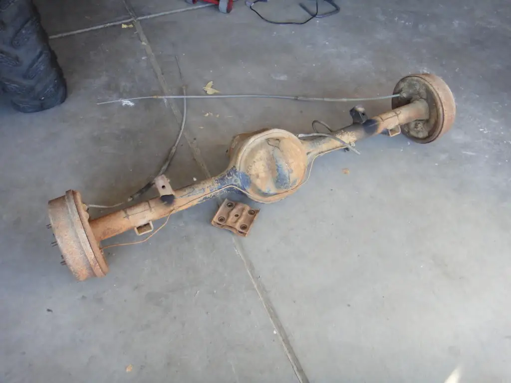

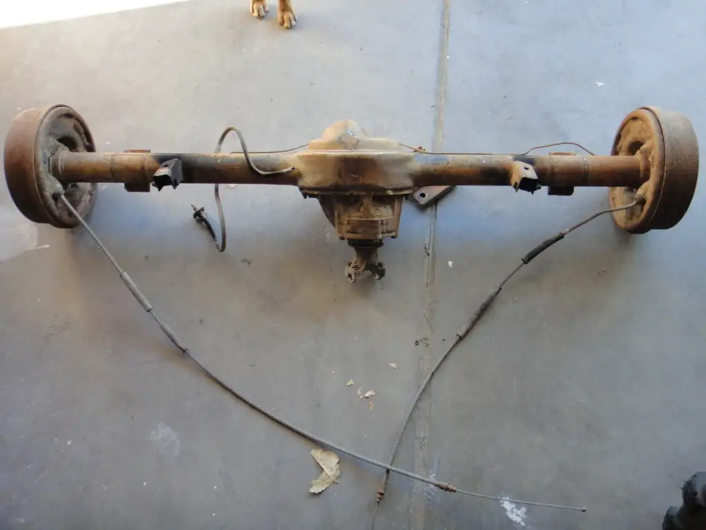

I just prefer the narrow width for a few reason's
The coils can be mounted straight to the frame. No spacing required.
The roads in Colorado are skinny skinny. I like the --old gauge railroad width
I am of the opinion a narrow width should result in less wind resistance up front. Hopefully this helps with fuel efficiency.Narrow tires also help this, however they look real goofy on full width axles.
The tires will stick out less of course
And looking at your pro list, at this point I know what I would do. You would have the opportunity to triangulate and 4 link it instead of welding in wedges, and avoid a trac bar.
You might find fitting and spacing the coils to be as time consuming as shaving the axle.
It is easy for me to say this though since I am just watching this happen.
Stic-o has full width axles on his truck, and I like the narrow track he has achieved with the wheel offset and back spacing. . However, it is still about 3" wider than the narrowed width axle.
