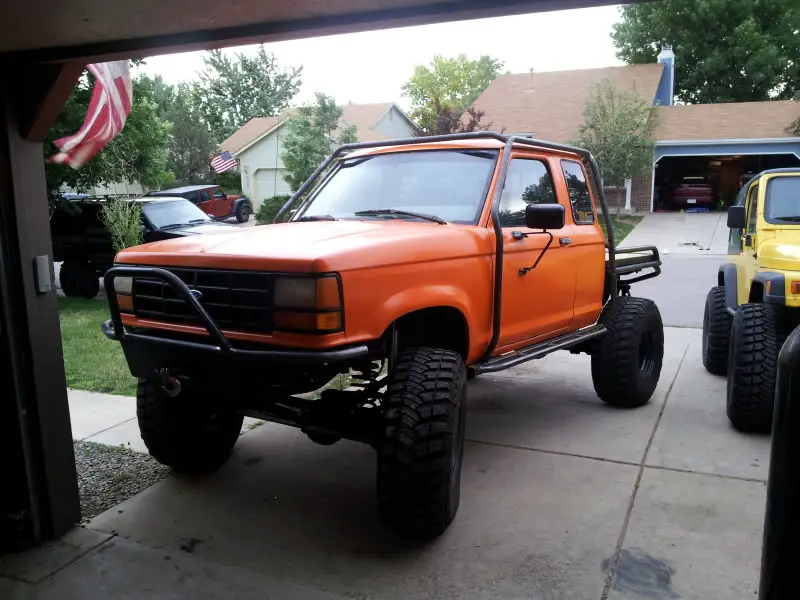

Yes I have a issues I can't stop messing with these Fords. This is my personal project, but not my first SAS Ranger project built one for buddy and he helped me. Which was my 2nd Ford SAS my first Ford SAS was my DD Project Merc (98 Mercury Mountaineer 5.0 V8). Already have about 20k miles on the Merc in little over a year.
Merc build thread here...
http://www.explorerforum.com/forums/showthread.php?t=303902
The first Ranger SAS was TNT here is pic...
My new Ranger just picked up April 15th 92 Ranger 4.0L 4x4 bad tranny picked it up for $750. Truck has 159k and pretty rust free just a few spots here and there. Code name Rock Ranger otherwise know as Double R.
Already sold the 8.8 and bed off it. I will be keeping this one pretty simple very similar to TNT.

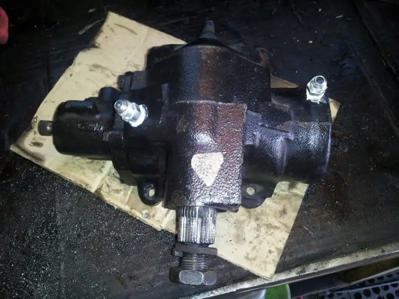

Had a little time this afternoon decided to tap my new F150 box for Double R.
JIC #6 / 1/4" NPT fittings installed...
Ready for install when I have time next couple days. :D

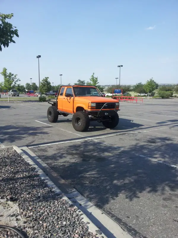

So I have put about 1500 miles on the truck so far. Thing is a beast drives great. PO really let things kinda fall apart on the poor old truck. Nothing major other then the trans(fixed most everything else so far). And now the radiator needs replacing(still works but weeps first thing in the morning until the plastic side tanks heat up and reseal I can just imagine it is time bomb though). Does anyone know a good replacement? The truck already has the same as the 91-94 Explorer since it came with air and auto. Thinking about using the 2nd Gen Explorer radiator and then just extending my bumper skid to protect it. Those are massive and should give me tons of cooling on the trail. Anyone know of a write up where someone has done that swap?

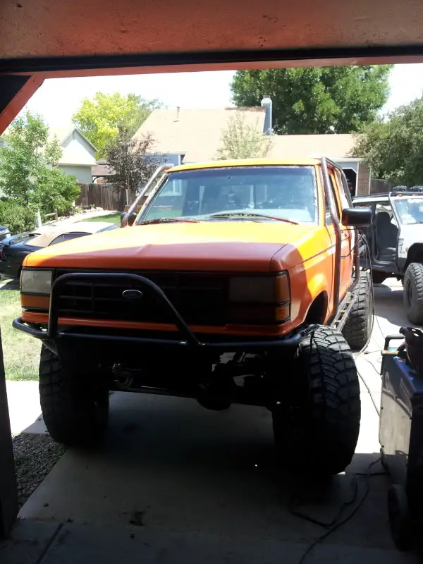

Here are few more pics of the beast.
In this pic I was testing out the hydro assist at 85 mph. Works great!
And couple pics of when I walked out and seen the truck and it made me smile so I had to take a pic. LOL

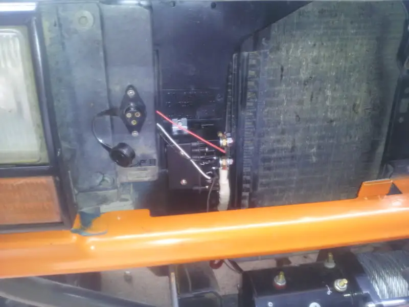

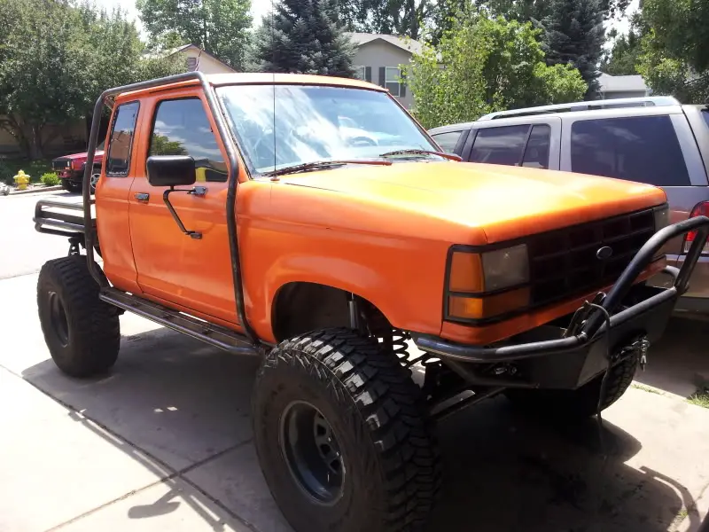

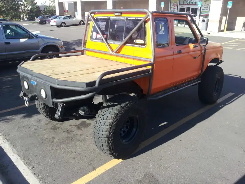

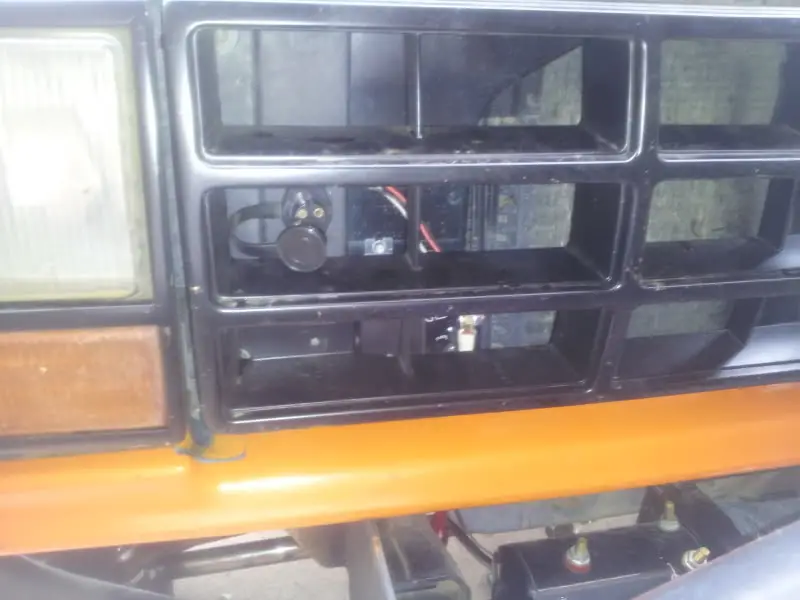

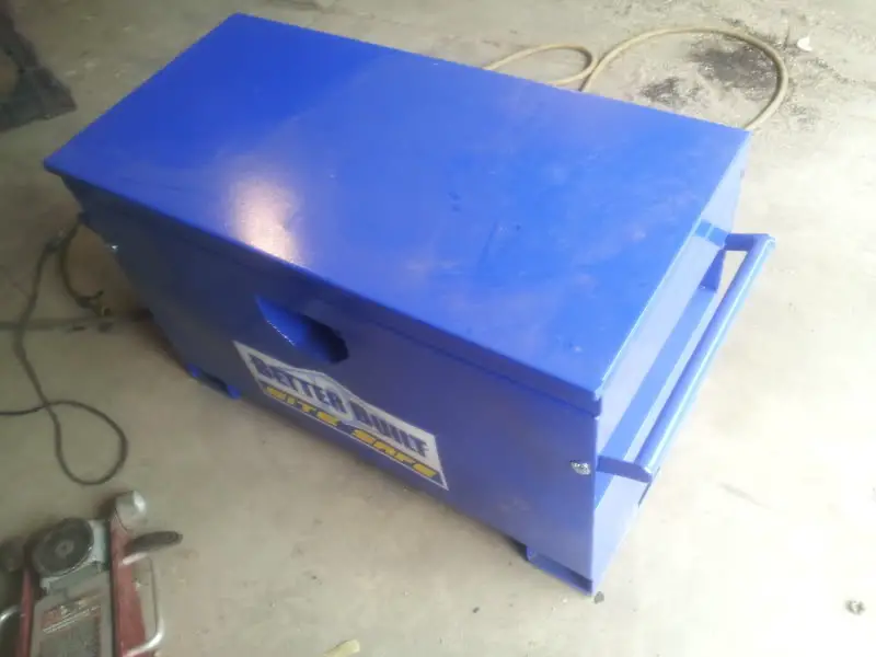

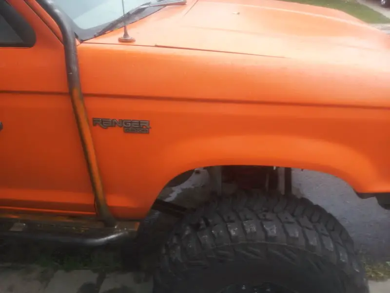

Worked on the truck a little today getting it ready for Holy Cross. Found a Ranger emblem at the JY and got the winch hooked up. Picked up a tool box for the back too.
Works like a champ!
