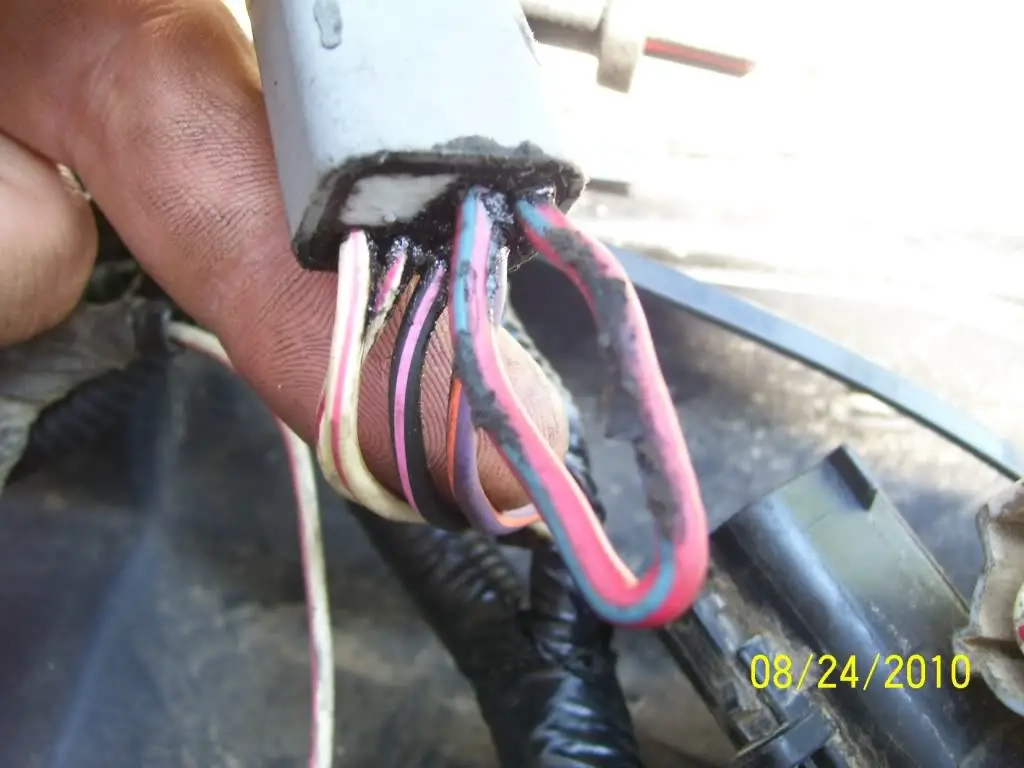

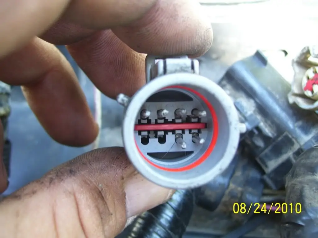

This is a picture from an automatic engine harness, but the round connector on the left (yours maybe black) is what your after.
Behind (in the loom itself) the round connector on the Dr side you will find the pink/blue jumper wire.
No need to tear into the harness, Just check the pins inside are making contact and didn't get bent up when re-connecting them after the swap.
