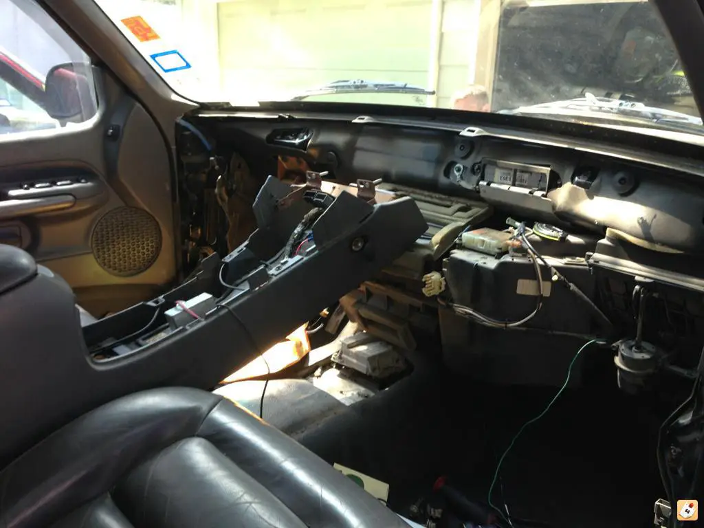

Well Kris and Russell took the dash out and found the issue with the brake lights and door locks. Appears the old alarm that had been installed cut into the wire harness for that and just corroded over time, so that's fixed thanks to them.

The old CB had wires all cut up, so added a new.
Got the gauges re-installed, still having an issue with the bulbs for those gauges but I'll deal with that later. Came up after I put it all back together surprise!! lol
Wired the CB under the center console into an outlet that John had already installed on the dash a long time ago. Swapped out the wire for the new CB and now have an uncluttered look for the CB.

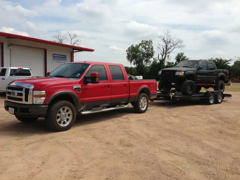

Got her loaded back on the trailer to go back to Torch Monkey Fabrication, they're going to adjust the transmission cross member for more clearance for the front drive shaft, and build a custom front bumper.
